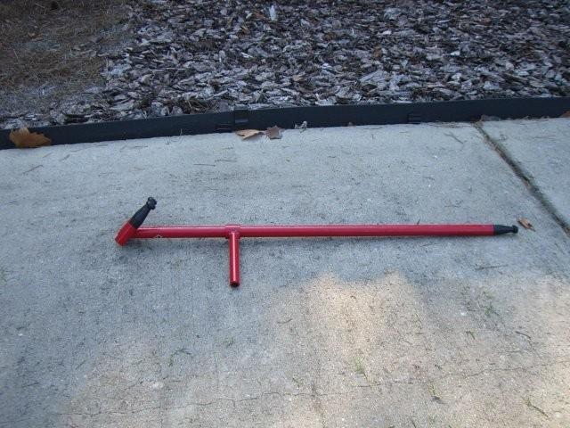

My Harbor Freight tire changer with motorcycle wheel adapter and a real tire changing tool with nylon tips has paid for itself after just 2 tire changes! I've helped fellow riders change their tires as well...this would be a great thing to go in on with a few riding buddies, with 3 people it would only cost about $50-$75 each initial investment and you would save that with the first change.
