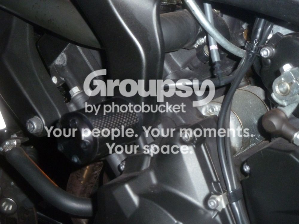

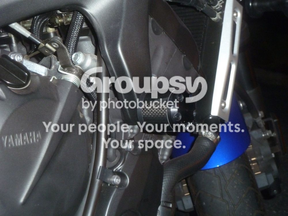

I think they are a great idea but never really thought about them until they came with my FZ.
Not sure who made em but these are mine (looks like one already had a little use, and there's no other damage on that side so I'm even more of a believer)
