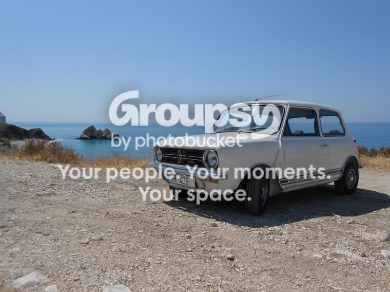

...I purchased a 40 year old Mini (see pic) and re-built it. It took much longer (and more cash) than I'd anticipated and the FZ was trapped at the back of the garage behind the shell and all the associated parts...

Very nice Mini!
