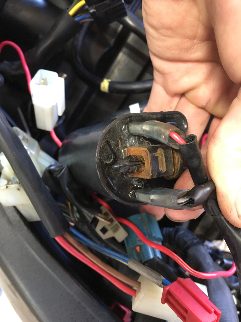

Final, can you give me the lowdown on your fused connection. I ordered the Bussmann you recommended. Just plug it in place and wire up the power to the FC?
Correct! I opted to add dielectric grease to the exposed section as the door no longer keeps the chunks out....
Get some shrink tubing and bare butt connectors and you're set.
Something to keep in mind should you **EVER HAVE** a no start situation is that most all of the fuel controller inputs are passthrough except the fuel injectors.
That said, simply unplug FC injector and connect it back stock so injectors are direct to ECU. As long as those other inputs are not compromised (shorted ect) you should ne good to go!
I've never had issues but I have resolved others issues by bypassing the PC FC's that had a hiccup.
