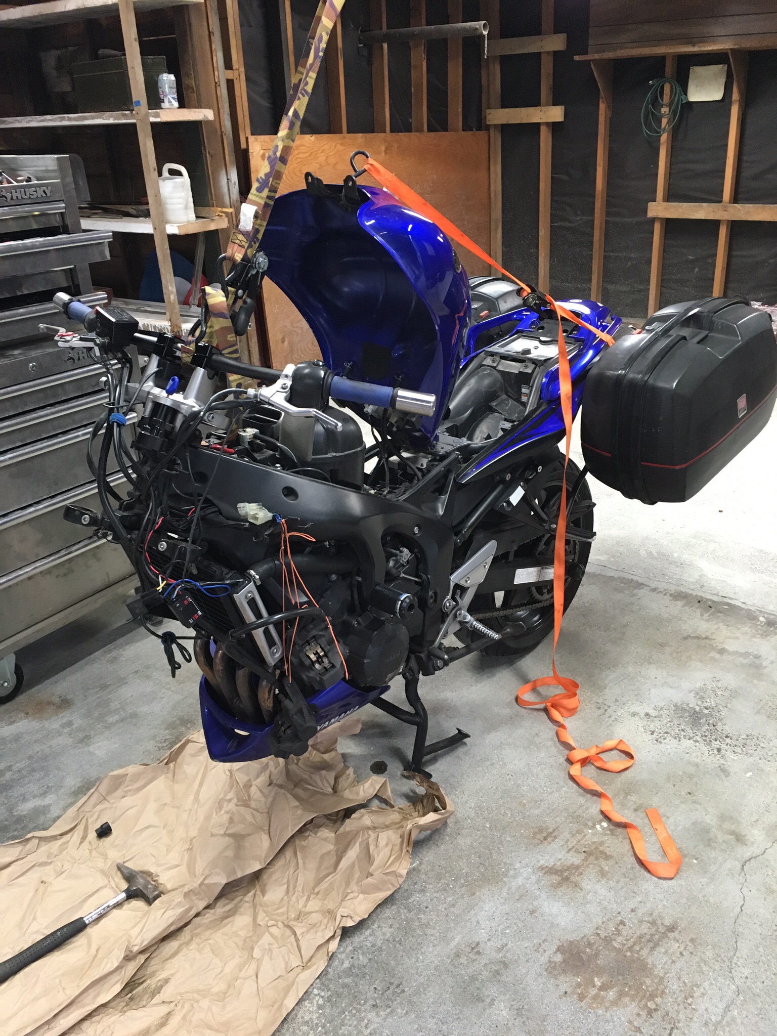

Good tip on the jack. I used straps last time to support the bike from the ceiling. Will have to rig up something more sufficient.
Here was my setup last time with a bunch of ballast in the boxes:
I have not sorted out the rear brake but it's on the list. In the air everything lines up pretty decent.
As of this moment the forks and fairing are off of mine and I saw that upon removal of the remaining fork the CG (center of gravity) allowed it to settle on the rear... In a controlled environment I'd leave it, but there are critters and wood is abundant. Simply press on the seat and push a stack of 2x4" under the header. Problem solved.
Currently there is a thick blanket on the tank in case something flies through the shop. My thought when leaving her was that blanket would also make a nice roost for that damned cat and that could be unfavorable. lol

A simple, screw, scissor jack (likely in the trunk of your cage), fits nicely under the header and won't bleed out.
I have one from an old crown vic (with a block of wood attached to the top) that seen more of my header than the Crown Vic... Very steady....
