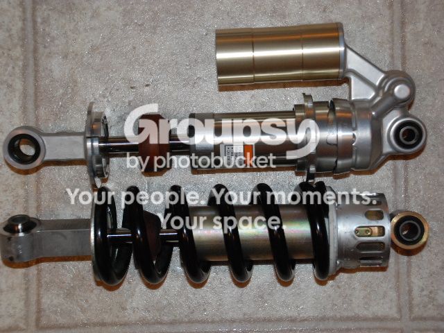

What it does: the rear shock assembly is 300mm from eye to eye. The end which retains the spring is removed and a shorter one is installed. Removing ~20mm from the shocks length will easily drop you an inch. Then slide the forks up the triple to match so the bike handles properly.
Its not a high level of complexity but with the spring involved its best to hand the shock to someone to compress the spring, remove it, install the lowering link and then put the spring back. Look on fleebay for the link.
Pic below:
Left end is the bottom which can be shortened (aluminum section).
Right end is the adjuster. Put a spanner wrench in it and turn it. You can only increase tension until it goes to seven, then it drops back to one with a jump and bang as the spring unloads on the collar.
FZ is the lower shock asm.
