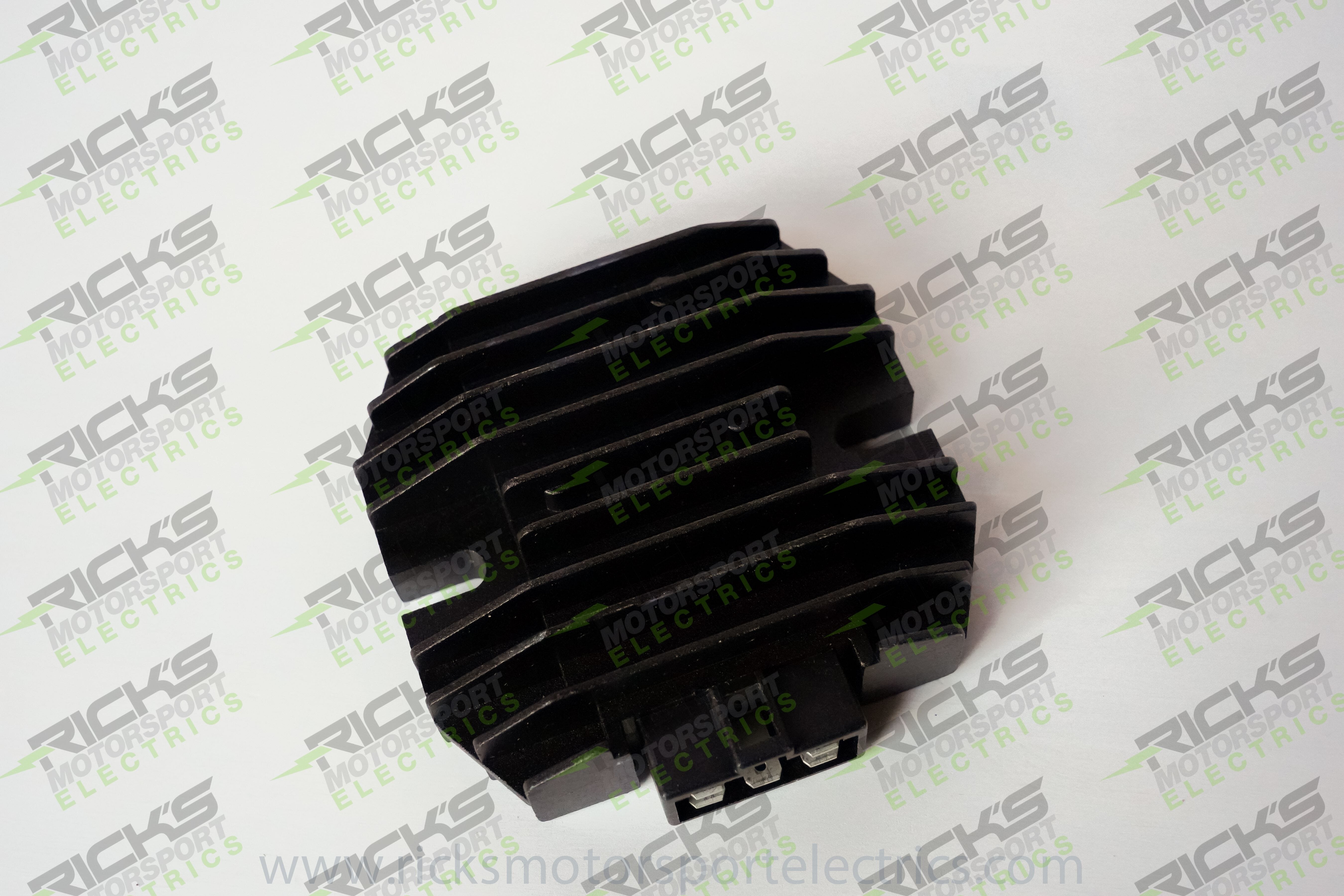

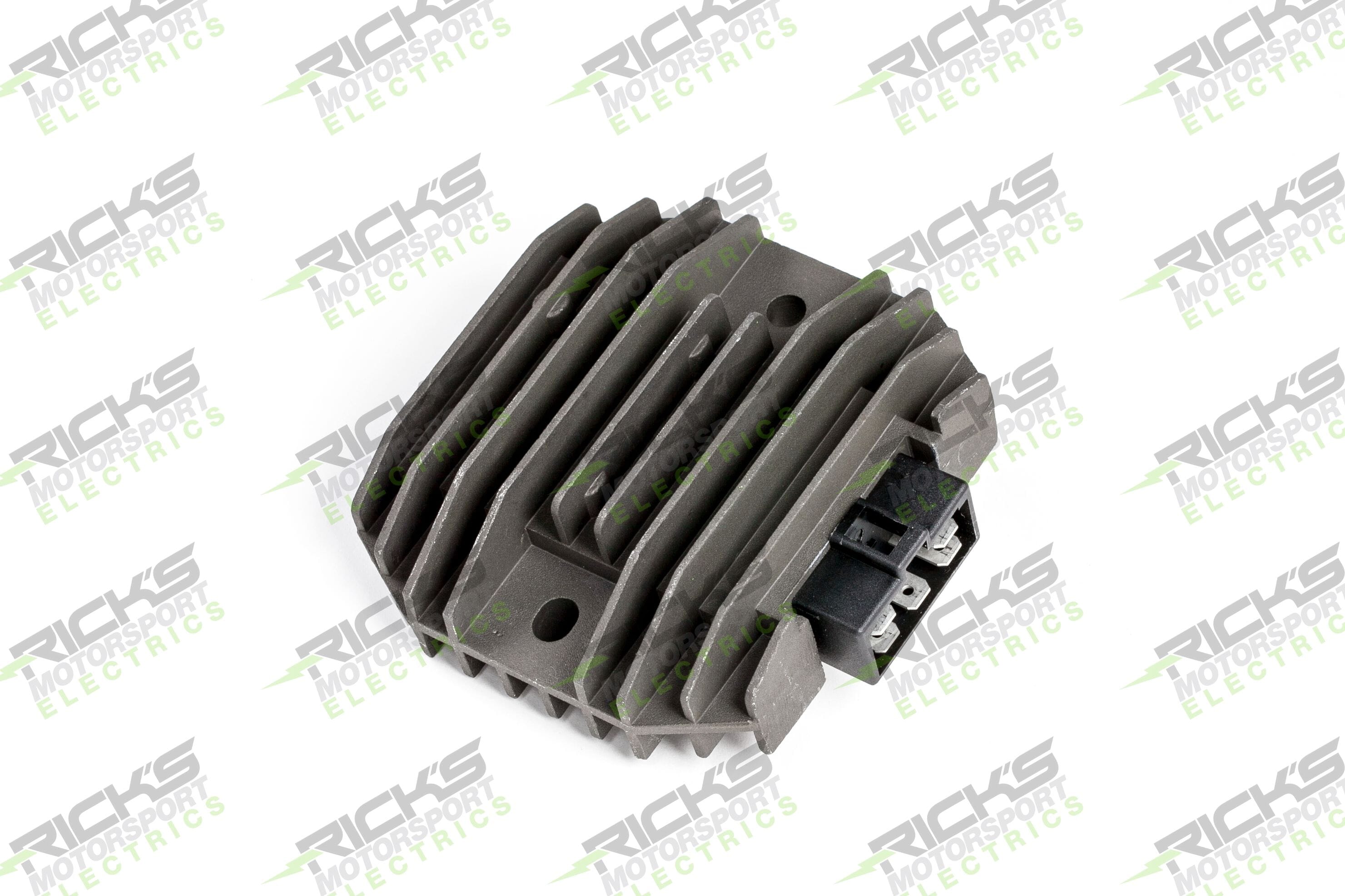

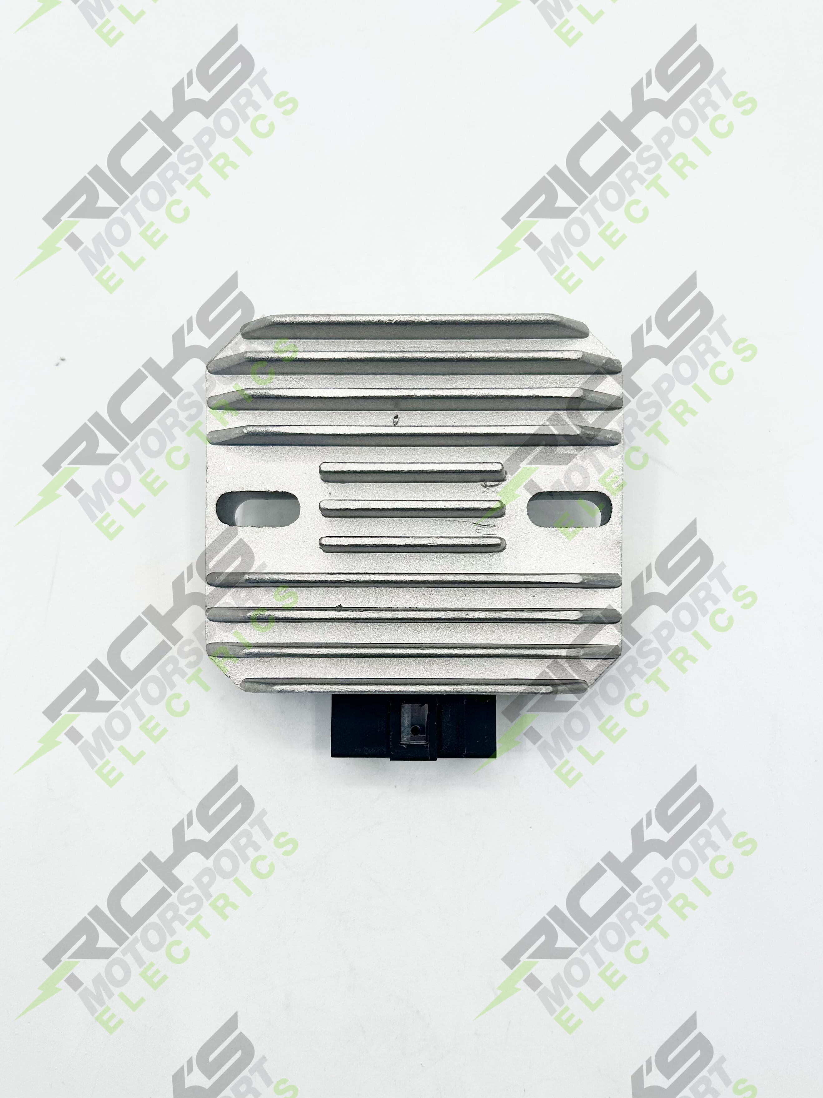

An upgrade for the OEM R/R would be a MOSFET based unit. The OEM is diode based (SCR) and shunts excess current to ground, while a FET based R/R provides switching. Whatever you do, don't buy a new one off eBay. A used OEM yes...but not a new one - it will be import crap (Shindengen).
While I have not used one, Ricks has a good reputation:
You will also note that they have an OEM replacement diode unit for $80.
Or a diode unit that regulates at current suitable (14VDC) for LiFePo4 batteries - $95. Only necessary if you are using a "dumb" LiFePo4 without internal protection.
