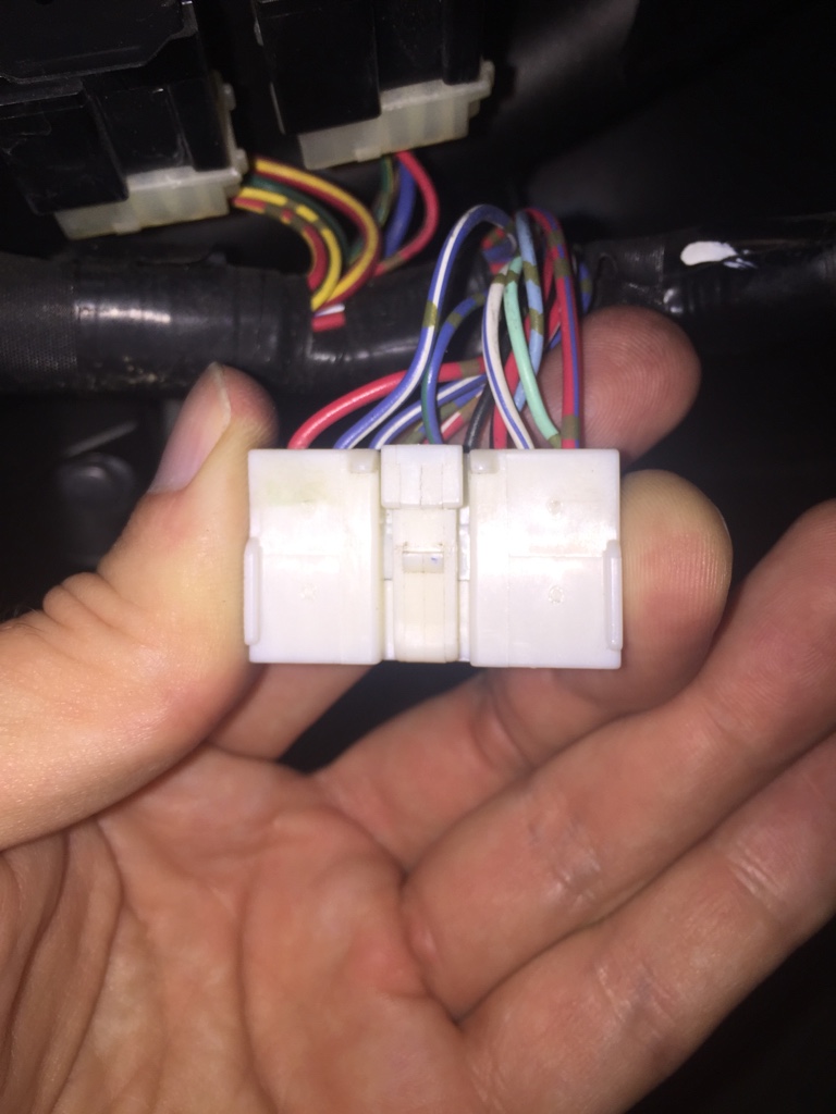

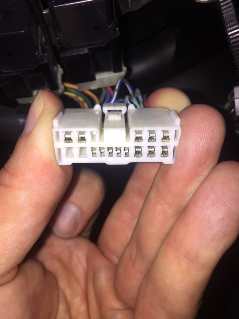

Ok understand. Now my connector does not have numbers and the colors are confusing. I'm attaching 2 pictures so you can probably tell me which one is what?
Thank you again for your patience!!

Put you meter in the ohms position. your meter should have a few ranges. You want your meter on the 1X setting or lowest setting. If your meter has an auto setting press the range button so that there is no M or K in the readout. The meter will probably read OL.
Clutch lever switch test
Attach one probe to the black with red tracer wire pin and attach the other probe to the black with yellow tracer wire pin. Operate the clutch lever. you should see the meter show that the switch is operating from an open to a closed reading on your meter.
Neutral switch test.
Attach one probe to the plain blue wire pin (no tracer) and attach the other probe to any ground.(Engine frame or negative battery lead. Operate the shifter from 1st to neutral.. You should see an open and close indication on your meter.
Side stand switch test.
Attach one probe to the blue with green tracer wire pin and the other probe to any ground as in the previous test. Operate the side stand up and down. You should see an open and close indication.
If any switch fails the test, repair or replace as needed. and see if the bike will start and run. If the switches pass the tests there is high probability your module was shorted and has blown diodes. The fact that the bike ran when you shorted the neutral switch to ground implicates the neutral switch but as soon as removed the ground the bike died. If the side stand was down the computer saw this as a danger and stopped the engine because it thought the bike was in gear even if it was actually in neutral.
Do these tests and get back to us. Don't worry if it takes a while to figure out. Take your time, relax and enjoy repairing your bike. This is the Zen part.....
