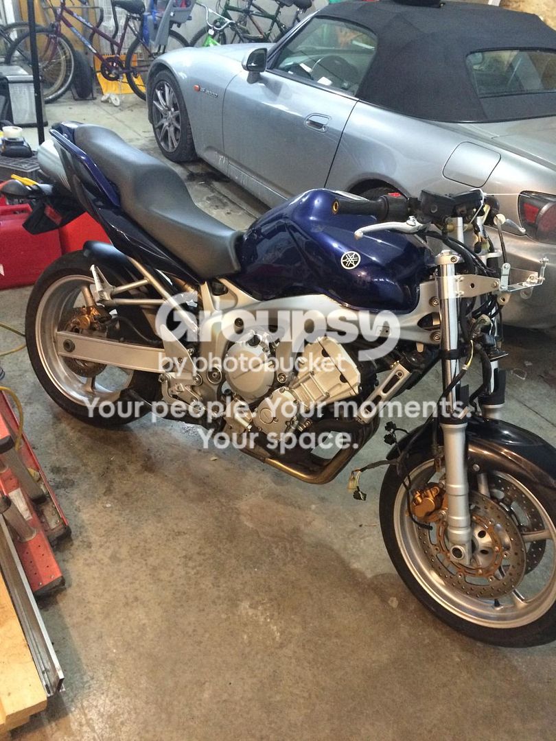

I started out by painting the welded arm of the frame. I was able to find a paint that was identical to the frame color, now it looks great. I also tightened up the frame bolts and shimmed the wonky arm. Now time will tell how it holds up.
I started working on cleaning up the chain to get all of the rust off. This rust removal will be an ongoing process so it's not done yet.
I installed the right side brake bracket that was removed due to the old one being broken.

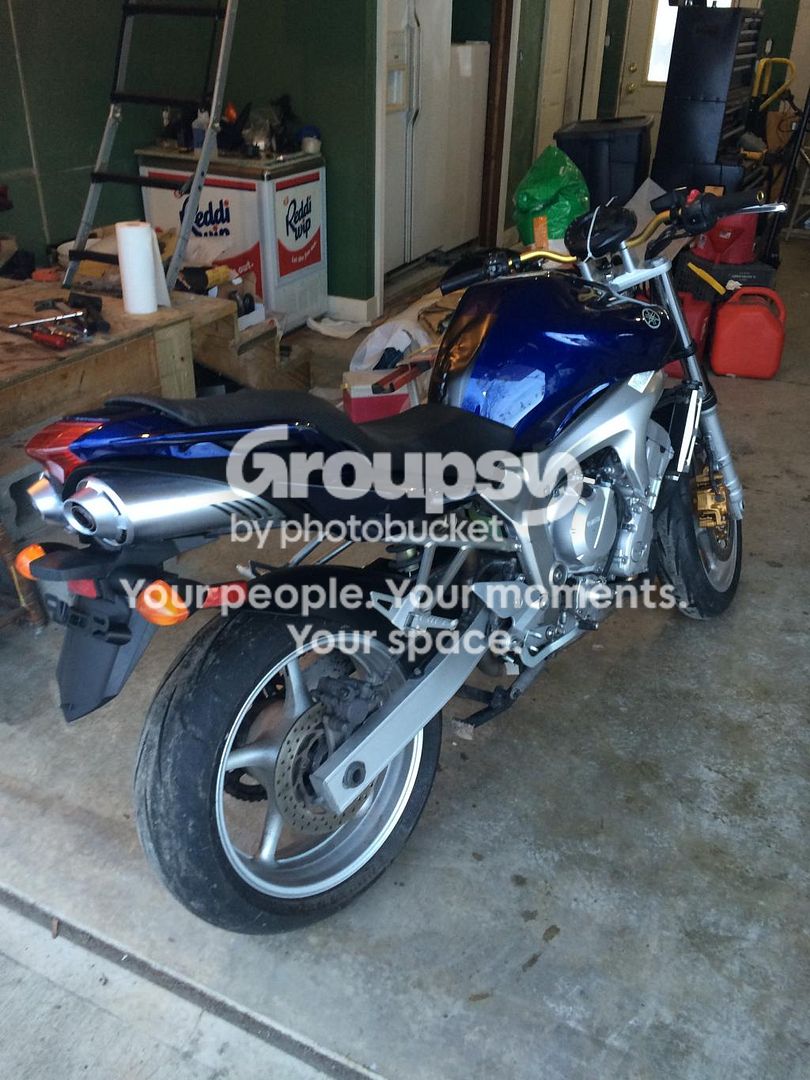

I also dyed the rear fender black like the other plastic pieces and put it back on the bike.
Then I finished installing all of the plastics on the rear and the side, as well as the seat. I also put the headers back on.
I also finished bolting all of the brake hoses to the forks and installed the front fender.

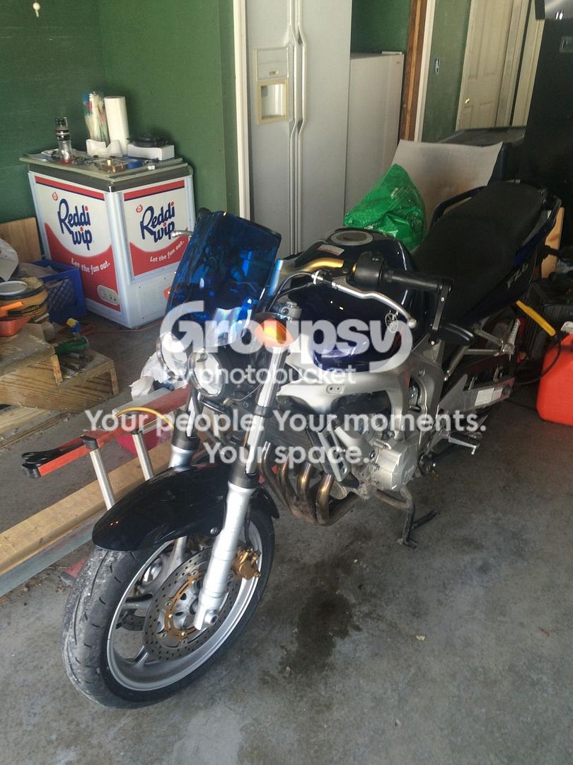

Finally, I started test fitting the headlight brackets and the Buell headlight.
Tomorrow I will probably work more on the headlight install as the bike is nearing completion. Yay!

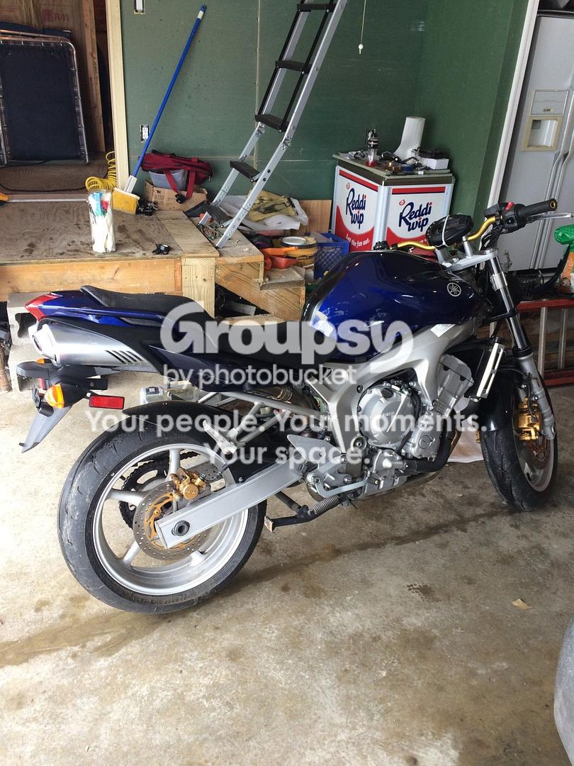

Well the bike is starting to slow down now as I'm finding myself with less and less to do on it. I did take it on a short test drive down the street and I was pretty proud of my mechanical skills, I didn't die or wreck! It was the first time I've ever ridden it and the first time I've ridden an FZ6. It was a lot of fun, even though I only got it up to about 30 or so without going on a main road (I don't have a plate). Everything held up okay so once I finish it up I'll be anxious and nervous to take it up to speed. Hope everything is tightened. :rolleyes:

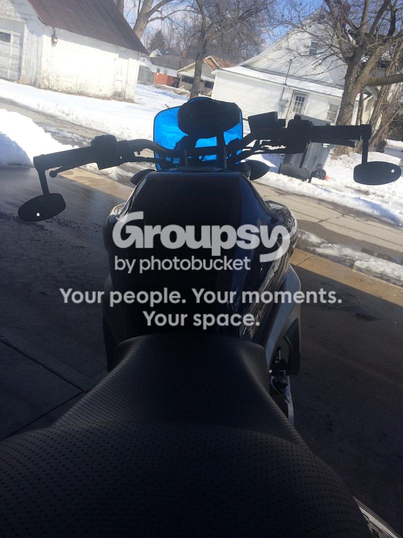

Finally, I was struggling with my bar end mirrors I purchased because they wouldn't fit in the end of the Renthal bars. Apparently, Renthal bars have a 14mm ID (which I've heard is weird, but I can't verify that) so they universal mirrors nut and rubber were no where near fitting inside the ends. I had to make a trip to a hardware store and buy smaller allen bolts, special self locking ends (have no idea what they are actually called), and smaller hose that would fit. I had to trim the diamter of the locking ends down because they were too wide. In the end, amazingly, it worked.

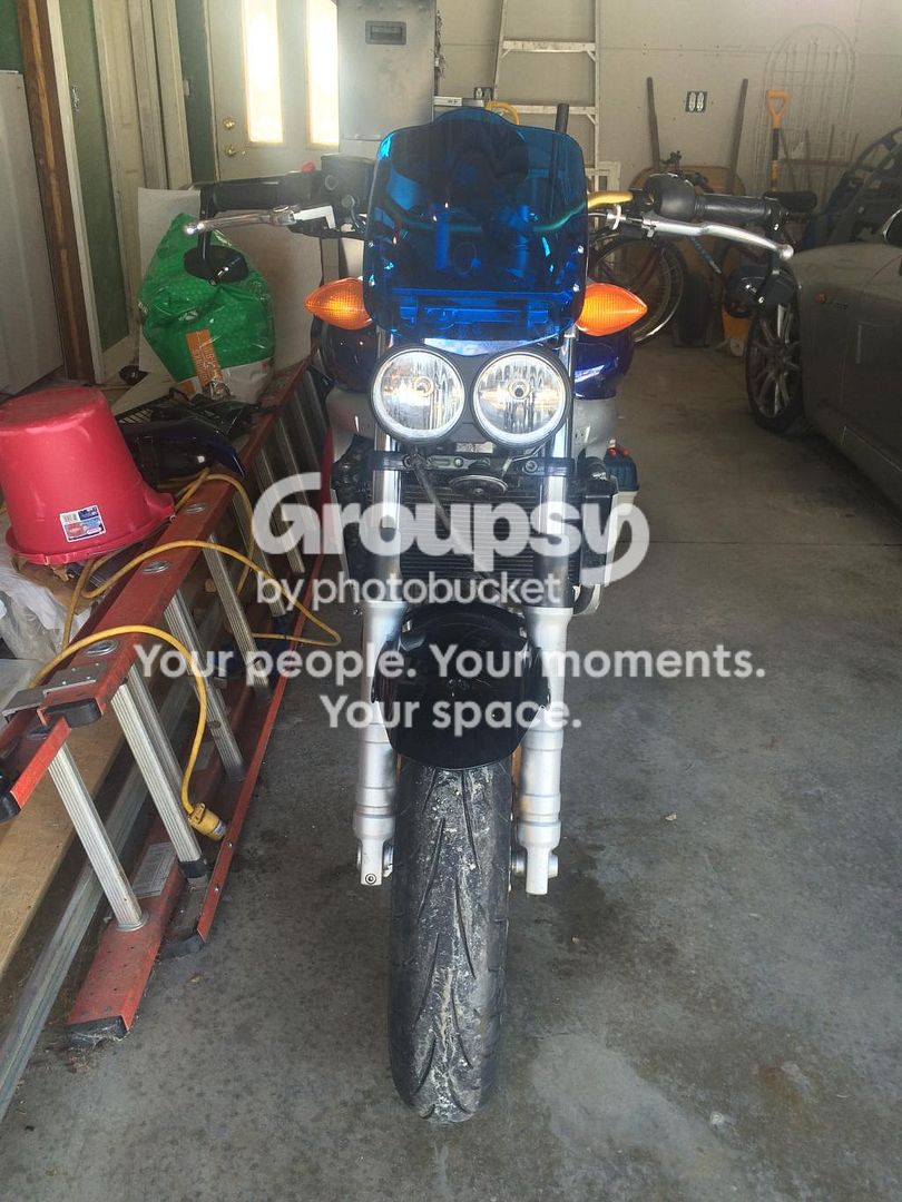

You're probably aware already, but those lights are pointed a bit high for road use (they won't show you much of the road aimed like that). So make sure you point them down range before you take it out at night!
Haha ya, I haven't tightening anything with the headlight assembly yet, even the fork mounts so everything is just kind of hanging there. I'm not tightening or adjusting until I get the fairing so I can tweak it to the correct position. I agree though, visibility would kinda suck LOL :thumbup:

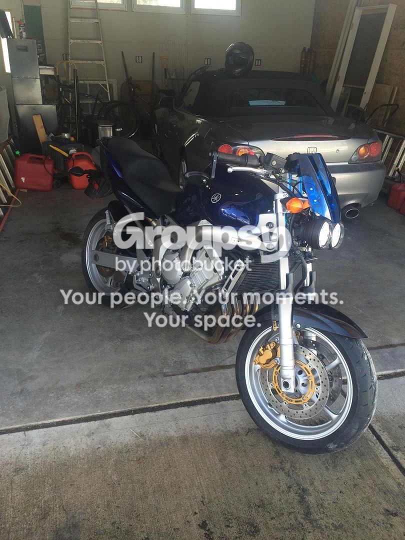

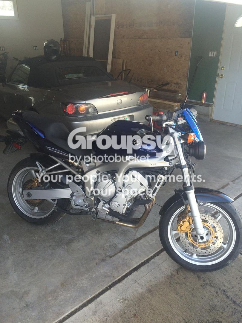

I got the fairing! Yes!! So I was able to basically finish her up today, minus the stupid foot peg. Once I knew how high the fairing would sit and where to position my gauge, I was able to tighten everything down.
For the time being, I just decided to reuse the stock front turn signals. I don't have the energy to figure out how to convert 3 wire running light turn signals to 2 wire flash only signals. So I used the shortened stalks that I unbolted from the old fairing and they pretty much bolted up to the fork ears with little customization. They look hideous I know, but they work...
I kept running into the problem of the cables behind the headlight assembly, pushing it outward when I turned the wheel left, not matter how much I tightened everything. I came up with a quick solution. I should probably make a bracket to replace this but it will do for now to keep me from having to readjust the headlights. I ran I heavy duty zip tie from the horn bracket to a bolt in the bottom of the headlight assembly. This will keep it from getting pushed outward. It works...
I made a quick bracket for the gauge to see where it would sit. I still need to make another bracket that is much more substantial and gives more support but this will give me an idea of where I want it to sit. The location fits will with the fairing and still allows access to the key without the gauge being buried down behind the handlebar risers.

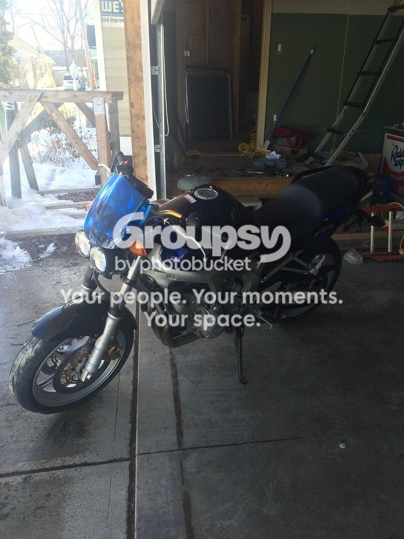

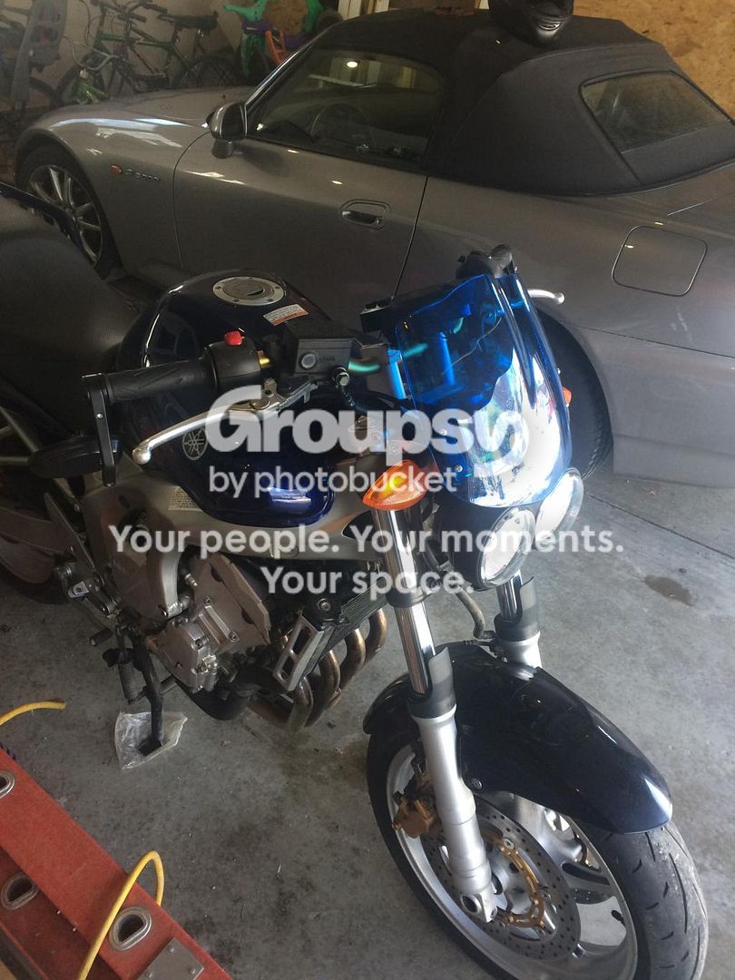

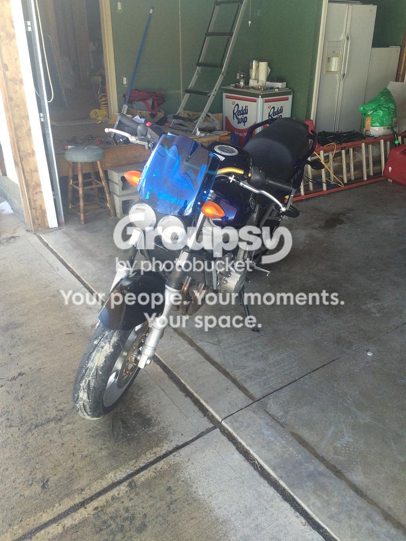

Then I decided to snap a few quick pictures of the full package. As my wife astutely pointed out, the color of the fairing doesn't match the rest of the paint. I got the clear blue fairing because this summer I want to paint the bike to match it. So for the time being, it looks a little off, especially with the black front fender, but it will all come together once it gets warm.
Well, there you have it folks. The FZ is officially reincarnated. Thanks for following the thread. I'll be posting a list of the parts I used, with part numbers and where to get them so if you're looking for something I have, it will be referenced. If you have questions, don't hesitate to ask. Once I get it out of the garage, I'll be sure to get more pics as well. Thanks for following my FZ rebuild! :Sport:
