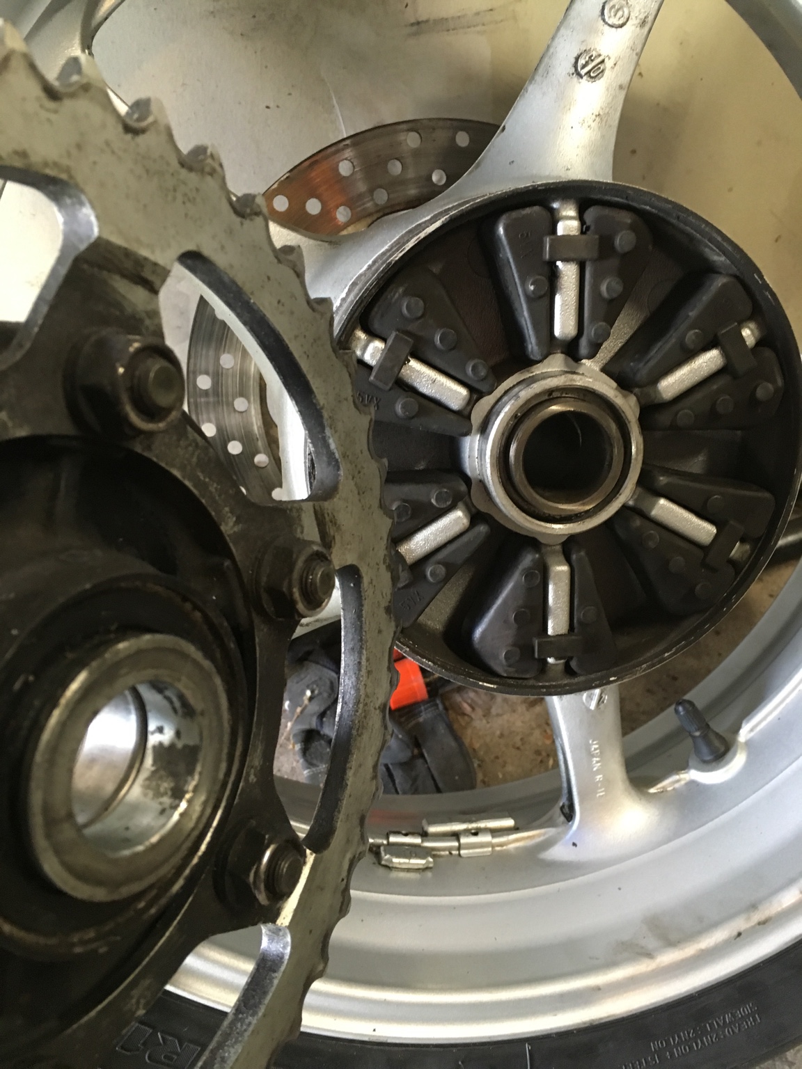

One other thing for the OP to check and probably not it, the rubber cushions inside the sprocket carrier.
Check and make sure one didn't pop out slightly, etc. They do fit pretty tight, I usually spray em with silicone.
upon assembly. That WOULD cause some improper spacing..
