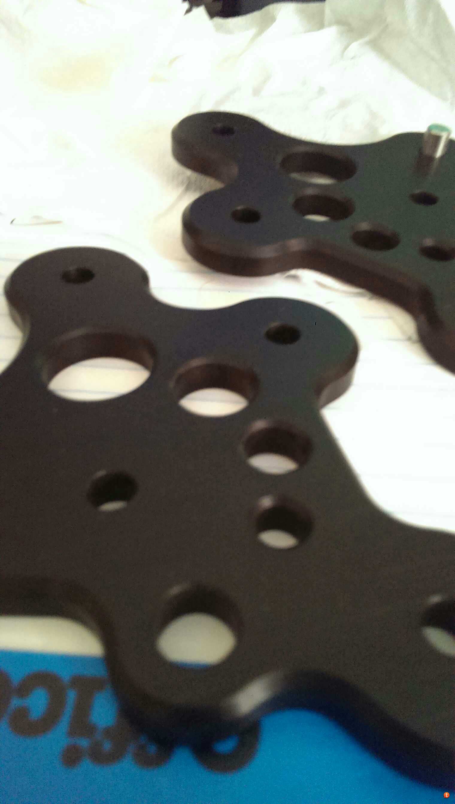

They were in my mailbox today when I got home. Looks like I know what I'm doing tomorrow!

Also received my plates! BTW - my plates look better than your! ;)
Actually the plates look awesome! very professional.. :thumbup:

Picked up my plates on Friday and installed them today. The new feel is awesome!! I ran into a small snag on mine and I though I'd ask if anyone else has seen this. The rearsets were bolted to the frame with two bolts and 1 'nub' that inserts into the rearset to form a triangle. The plates have a hole drilled that accepts this 'nub'. On the brake side the distance between the bottom frame bolt and this nub was too far by maybe 1/8". Everything else was perfect, including the same measurement on the shifter side. I ended up drilling the bottom frame bolt hole in the brake side plate a little larger and it worked fine.
Anyone else see the same issue this time around? It doesn't seem likely that my bike would be different on each side. I am wondering if the right (brake) side plates may have been machined a little different. I did not directly compare the two before I drilled mine.
TLDR: installed the plates and they work great with a little modification and thank you Oso2k!!
By any chance has your bike been down or stunted? All I can think of is that the frame was impacted on that side somehow, causing the difference in geometry. It is possible that you could have compensated using a shim or washer without drilling. :confused: Otherwise, the plates should have been mirror copies. If they're not, let me know.

It's probably a little late for me to check mine now, as 1) they're on the bike and 2) already modified the one. The previous owner did drop my bike on the side in question but according to his story (light marks on the clutch cover back that up) it was hardly moving. It may still be possible something bent between those two points though. If anyone who hasn't installed theirs yet wants to compare the two and see if they can see a difference then we can confirm that my bikes just a little bit special. Blah
