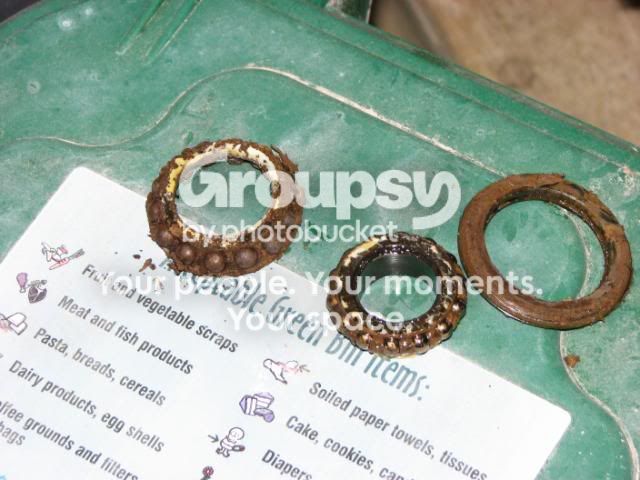

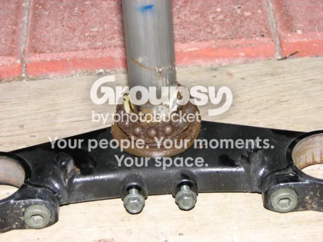

Mine started clunking over bumps at around 12k km, finally got around to replacing them at 16 or 17k km and the bottom was completely corroded and pitted, the top bearings could have been cleaned up. Either way, replaced with all balls and they have been fine since which has been about 25k km and plenty of rain

Mine were toast at 4900 miles, looks like the seal failed and would let moisture in. They were rusted, pitted and the ball bearing retainer was broken. replaced with roller bearings (All Balls), new seals and greased them well.
They're not actually seals, they're just shields.

Yup, mine were shot (corroded) at 10,000,the 04 t0 06 used ball races,06 on use taper rollers that fit straight in,Yamaha don't supply the earlier kit anymore.
the same but cheaper option if your seals are still ok is to replace the stock ball bearings with tapered bearings. here are the code numbers:
32005 for the top and
32006 for the lower bearing.
The code numbers are the same for Koyo and SKF

i bought my 08 with just over 9k miles on it. i replaced the bearings with all balls tapered because the stock ones were low on grease and showing some corrosion (not near as bad as the pics in this thread!). the bearings were around $35 (available through my local dealership). the job took two hours, only the dash panels were removed (in terms of body panels), and i used a large flat tip screwdriver with a hammer to adjust the castle nut. with the new tapered bearings, it takes VERY LITTLE preload, so a few quick taps with the hammer was all it needed to set.
