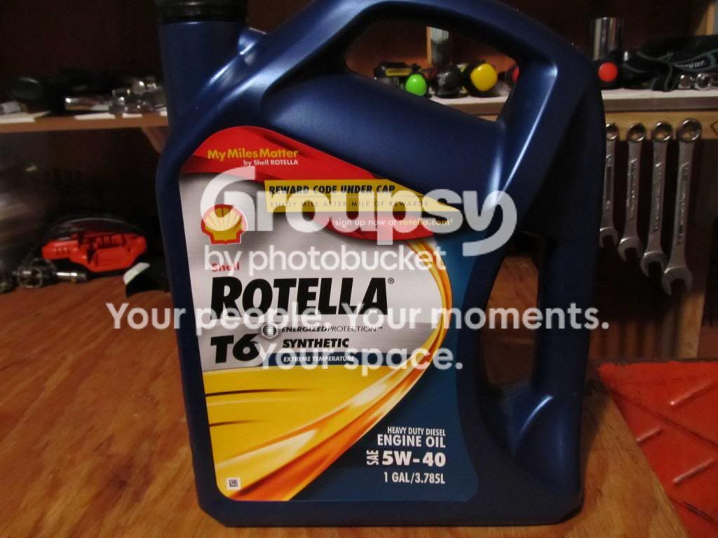

I was under the impression that T6 is a energy saving oil and does not meet JASO-MA. I know the T4 was JASO and I think T5 may have been. If someone has a container handy could you check, oil formulas change very quickly.
Nope. From a year-old jug. It would say Energy Conserving in the bottom of that circle.
http://www.600riders.com/forum/fz6-technical/50360-my-clutch-plate.html#post552819
Also.. I could be wrong (because this is strictly from personal observation), but xw-40 never seems to be energy conserving. Only the -20 and -30 seem to have that trait.
I've seen multi viscosity 5 20 and others in E/C. So Im not sure that's the ticket.
How about we all post up a picture of the product and specification. Feel free to include dino fluids...
I don't think any of the diesel oils are EC, at least I've never seen them.
All my jugs at work (including ones from a couple months ago bought from Wally World, so pretty fresh) say JASO-MA and don't say Energy Conserving... AFAIK the two are mutually exclusive.
I'll keeps my eyes peeled. :thumbup:
