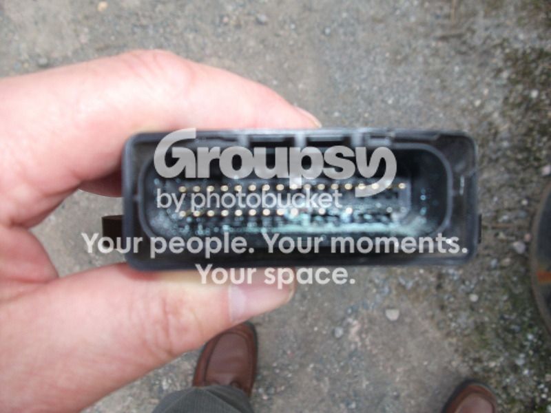

dolau, can you take a couple of close up pictures of the connector and ECM? Is it actually missing conductors?

Not a good picture but you can see the corrosion in the bottom right hand corner and the missing pins corroded away
Mechanic has to try and get the corroded pins out of the loom plug so that can be re-used and I guess a load of silicone grease or something like it so it doesnt happen again
Yamaha wont contribute anything to the cost so hopefully I can get away with the second hand 'Virgin' ECO off Ebay- he is just checking his stock to see if he has the correct one!
So- dont know what the answer is- should we check the plug and ECU regularly for corrosion or just wait to see what happens? I havent heard of this before with anyone elses bike and there are a fair few FZ6's out there!

On the plug there is a green with yellow tracer wire that provides a ground path for the fan relay coil through the ECU. The ECU operates this relay when the temperature sensor is at a specific value. That wire is the second pin in from the end. Which end and which row I don't know, but there is a good chance it's one of your corroded pins. Look at the corroded pins and see if one is to the green with a yellow tracer. Regardless when the pins are made right with a happy ECU you will know if the fan will work.
See attached: :)

The mechanic has found the problem- there is corrosion in the plug connecting to the ECU and two pins on the ECU have corroded away and are shorting out the other pins. This is a three year old bike that has done 8000 miles- not a winter hack!
Mechanic says I need a new CPU and possible plug but worse that that I need a new ignition barrel and new set of keys coded to the ECU and the whole bike coded to the ECU as this is the brain of the bike- Estimated cost approaching £2000 :spank:
I dont have £2000 to spenjd on the bike and so would be grateful if anyone on here knows which years ECU's are compatible with my 2009 FZ6S2? I dont know if earlier versions or later vesions would be suitable and hopefully I can find one on EBAY as a set from a scrap donor bike.
