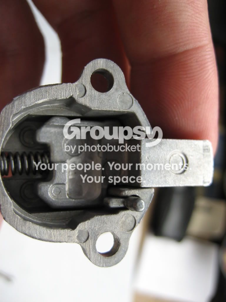

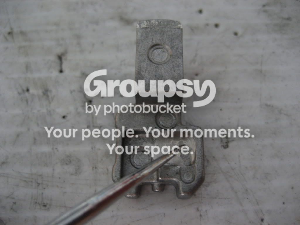

heres an easy 5 minute mod that makes life just a little simpler. using a dremel, i shaved away just a few millimeters of aluminum from the inside of the latch. this is the finished product...the area cleared is pointed out
latch back in its place
make sure you cover your gas cap opening so nothing falls in the tank. also, when removing the bottom part of the cap, make sure you dont loose the loose rod that stands vertically in the assembly. now you can put your key back in the ignition and close your cap by simply pushing it closed.
this mod can be done on any make or model, but just requires the shaving in a different area. i have done this to all of my bikes over the years.

stay with me guys..dont read words that arent there!
you still need your key to OPEN the cap. you just dont need it to CLOSE the cap.
this does two things: saves wear and tear on the key and lets you reset your trip meters while you fill up.
its just one more little thing to make life alittle easier. and besides, its an excuse to get out into the garage and tinker with the bike!:cheer:
