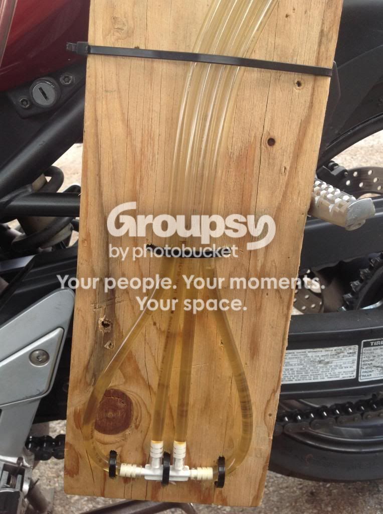

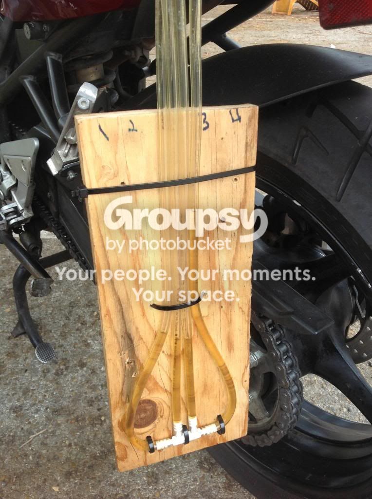

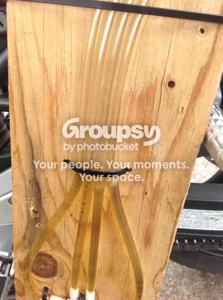

norcalwelder
May 8, 2012
189
11
NorCal/East Texas
Here it is while it warms up.
Warmed up
http://i133.photobucket.com/albums/q42/timpowell1/PhotoJul0422355PM.jpg
After adjusting, blipping, adjusting, blipping, etc, starting to get close. This is during the adjusting. The next picture is where it settled after a quick blip on the throttle.
Where it settled after a quick little blip on the throttle.
In a little bit I will have a video uploaded after this point where i show the adjustment as it gets closer.
