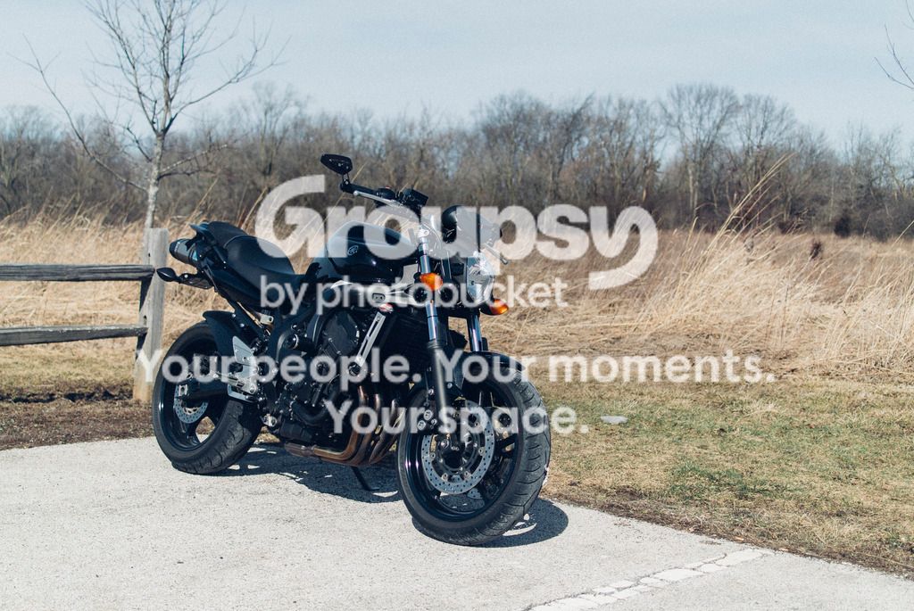

Started on some new upgrades for the coming season over the weekend. Excited to see how this turns out.
Also dropped the bike in my garage.... OES frame sliders saved the day, in fact they were literally the only thing to touch the ground.
Glad to hear the forks are installed!
It looks like you had the oem forks slid up about 10mm, I've found these are good around 8mm but I have a fairing.
You know what springs are them?
Also, check, set, and record you static and rider sag. Post up if you need insight on dialing any of it in...
More important Enjoy! :thumbup:

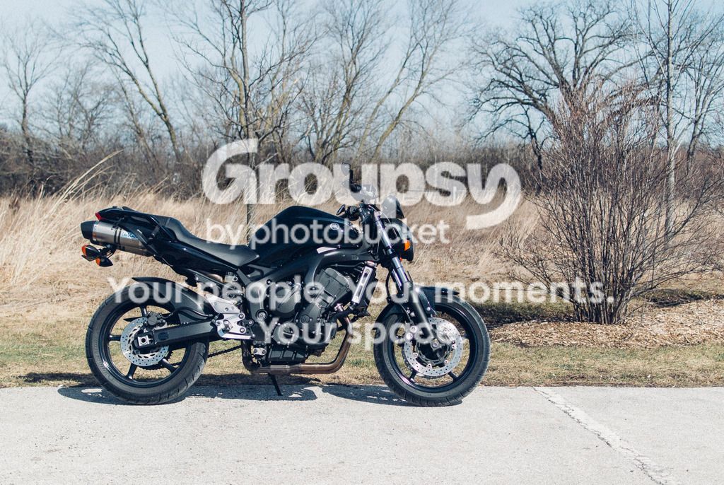

Yup, had oem up 10mm, r6 I have up 5mm. I measured the two forks and it seemed that r6 forks were about 10mm shorter than the fz6 forks so this should make me a bit lower yet up front.
My R6 forks are actually new old stock that I got a killer deal on so I'm assuming they have OEM springs still.
Gonna figure out the sag thing soon too, definitely need to get that dialed as you suggest. I'll have to watch some YouTube videos.
One more photo just for the hell of it. :)
What's deceiving is the high sag number of the oem springs. Meaning, although new forks are shorter, you can raise them more and still be safe.
Also the R6 are a fixed rate like the rear so corner entry will be far more predictable when the surface is irregular.
Mines at:
31 mm / 8 mm front
29 mm / 7 mm rear
Tip is this; reduce compression damping so it has minimal but is safe to ride (wont bottom by you pushing it standing next to it).
Ride and adjust rebound so it doesn't pack down but controls the nose. Once a happy spot it found adjust comp to your conditions... So your worst road won't bottom it out. Throw a zip tie on the stanchion tube. And push it down to the seal before setting out. Now you can see how much of the travel you are using... A Velcro riptie works well too.

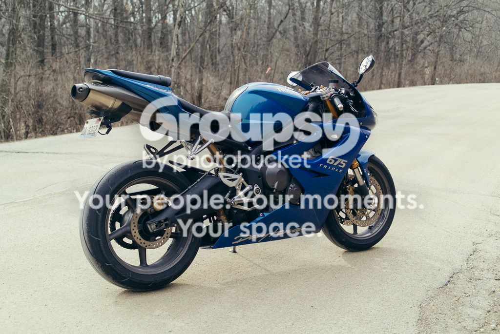

:) it was actually only a one day trade. I'm not actually sure I'd trade the fz6 for that bike. It was okay.

Haha. That would be one hell of a mod. I'm in the process of saving for a supersport actually. It'll be in addition to the fz6. I'm hoping to pick something up in May. I'll see though.
So I was just taking the 675 out to see if I really want one or not.
