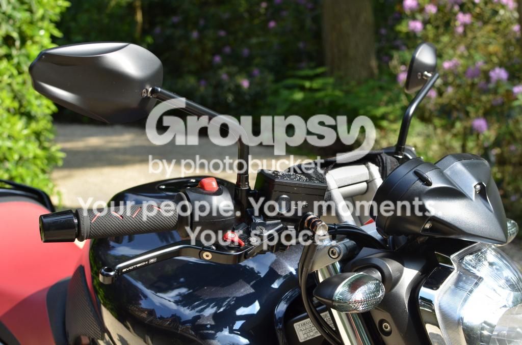

The FZ1 bars along with new grips and new footpegs. Top 2
The FZ1 bar gives you a lot more control, as do the grips and pegs, you wouldn't believe how much the stock ones slip around until you have used something else.

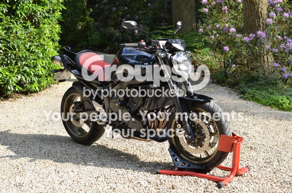

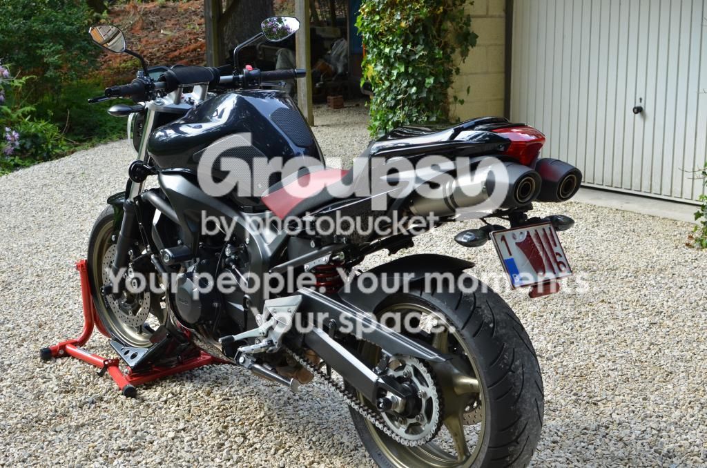

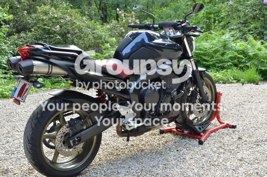

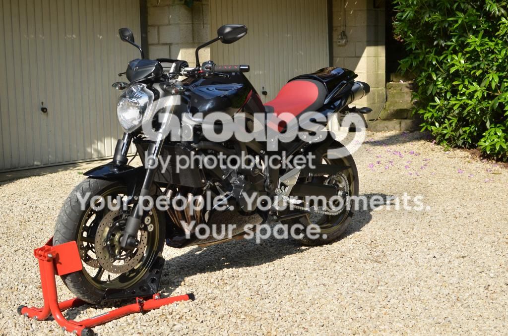

Now, the best part:
Looks Good and it sounds like you hit that happy spot where both ends are being compliant and behaving properly through the corners!! :thumbup:
Its NIGHT an DAY when it behaves as it should! It really makes the bike fun to ride!

Love your bike, might have to copy some of your mods.
Thanks a lot, since these pictures i have changed the rear sprocket to a +2, it is the same gold as the rims, it looks awesome!
I still have to instal the setback plates, have you done yours yet?
thisisbenji
Jun 20, 2013
710
Wadsworth, IL
No, I'v been putting it off, I'll probably do it the week before my next track day.
