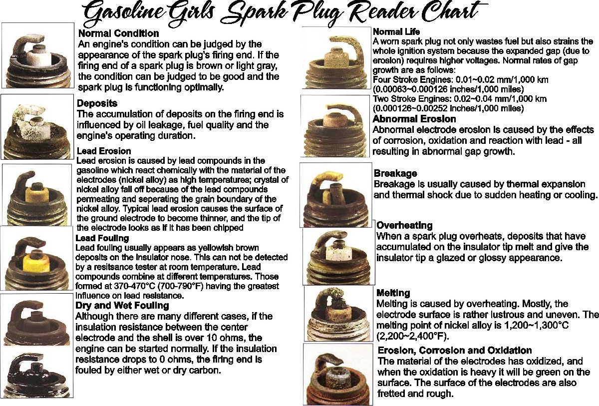

I rarely follow plug charts like that. They can be a bit of a guide but thats it.
Depending on where you get your fuel and the additives they use, the look of your plugs can easily different from those pics.
Also, depending on when you take plug readings, the color can change. For instance, if you have a rich idle condition, but read the plugs just after doing highway speeds, your reading will not reflect this accurately.
Plug chops must be done in a minimum 2 steps, idle and high speed.
After all, carbs have a low speed circuit and a high speed.
On my CB, if my plugs looked like your inner cylinders, That would be too rich.
When I tune a carbed bike, unless it is a really old style slide carb, I shoot for a very light tan to a light tan.
