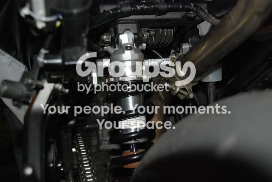

A pic worth a few words perhaps?
Notice the ramp is right on the body; no means of adjusting. It ended up being 1.5mm shorter and sadly that small amount cost the tail nearly an inch of ride height. When you top out the shock it needs good load on (like a spring) as once pressure is applied it continues to move. NOTE TO SELF: put a mark on the SHOCK BODY and measure from that MARK for both distances. i.e. the lower landing and the upper retainer. This way you're not just measuring the spring landing. you're measuring from a fixed point.
Plastic cutting = next to Nil! To be able to make rebound adjustments to the top I had to cut out thumb sized half circle in the plastic. On the huger I had to drill an angled hole (just over the brake hose mount in the swing arm) to the shock compression damping adjustment.
And no, I don't want my bike any lower so I'd opt not to slide the forks up any more than they are. Temps are now in the 30's around here. Its likely the bike will get parked soon.

From the pic I assume you didnt mill the ramp down. As per our previous conversation, I have the collars at the machine shop. They will be milling the ramp flat from the 4th setting on. The 2 nubs on the upper collar will be milled down 2-3mm. Do you think this will put it in the middle somewhere?
The 1st and 2nd flats in are merged as one.
And I'd simply try it. Honestly that top retainer does appear to have step worthy of couple mm. So you may try swapping the FZ steel retainer on there if need a bit more room.
OK, now I understand what you did. Did you not go with the adj. collar?
O' i see you just scan the pics!!!! No Reading eh? :spank: :spank:
This was an informal test and the goal was to keep it cheap until you know if it works as AN ACTUAL IMPROVEMENT, NOT JUST A PLACEBO! Yes, I got excited when I thought I could solve my problem with $money$ but then it wanted more money I didn't have. So I threw it together. . .
I suspect our implementation of this shock to our bike is going to consume 95% of the shocks ability to work as intended valve action wise. I've already used up most of the rebound trying to match what I had.
