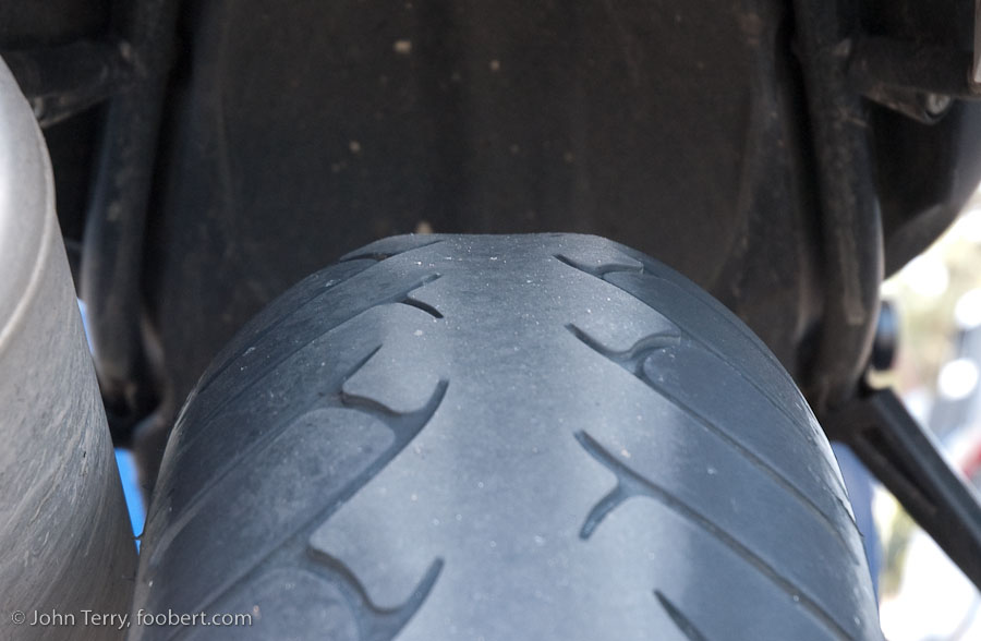

As said above, tires change shape during their life. If you do a lot of highway/straight line riding (commuting), then tires will get squared off. This can lead to decreased ease of turn-in.
This is an image I just found on Google that shows a bad case of squaring.

This is how the front tire looks, sorry it is kinda dark outside, and my bike is dirty as crap right now.
Definitely some squaring off there, but what about the rear? If that's squared off, it's going to hugely affect how the bike initiates lean. And usually, rear will square off more than the front with same miles on the tire set.
Agreed. The rear tire should really determine if the issue has to do with squared tires.

The op is in Texas. I'll bet you a small drink at a large drive up window the rear is squared.
Time for some good new tires

A picture is worth a thousand words. Yes, I think you've identified the problem. There's nothing else between the bike and the road. Your tires are the most important component. A few hundred dollars will save you possibly thousands. Good tires are a good investment. :thumbup:

I'll be honest with you, your tires are junk, they were junk when they were brand new and they're junk now. Just spend the money and get a decent set of sport touring tires. There's a lot of good brands out there. Do that and I promise your turning issues will be gone. And if your still not sure, ask yourself this, what do I really want between my skin and the asphalt.
What size is that rear? Looks like a 190!
I think Texas supports BIG Chicken! :spank::spank:
OP - nothing personal ^^ ! Grab some new tires it will feel like million when into those next corners!
My previous front had the shape of a Razor blade and it was EVIL! You'd be turning and then the bike would fall in MORE and rather unexpectedly! Tires matter! :thumbup:

Just looking at the wear pattern and coloring of the tire, it looks like these do a fair bit of straight line riding. They're definitely squared off. I would agree with the general sentiment that new tires are the way to go.
