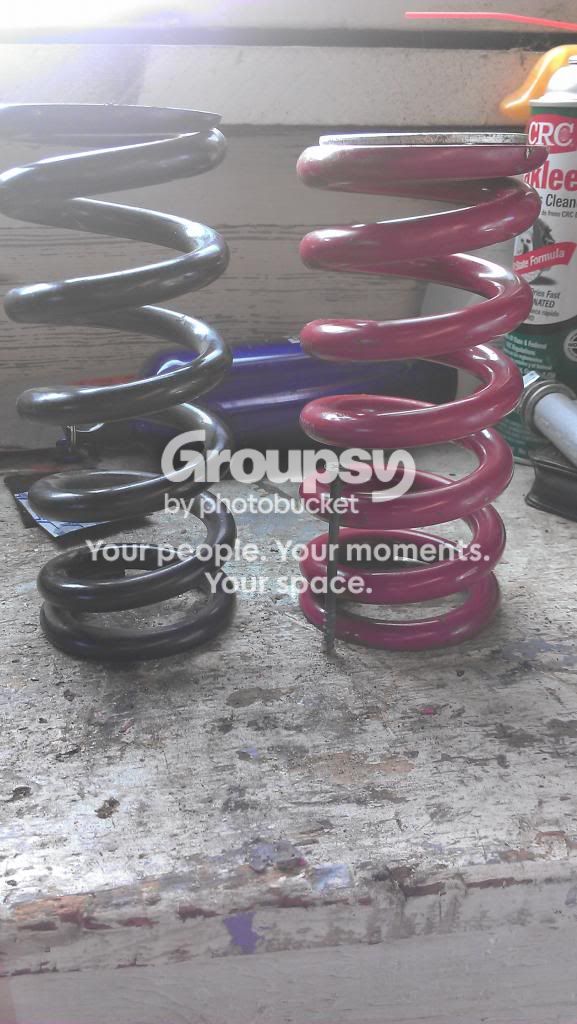

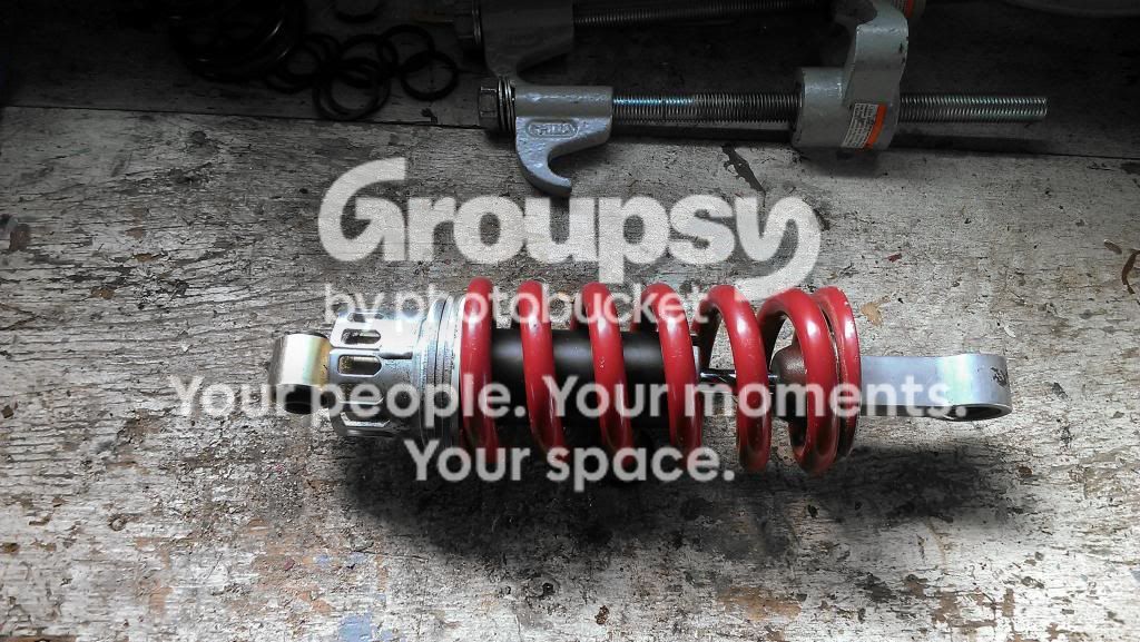

Ok, got the spring swapped out last night. I was able to get the stock one off with a rental tool from O'Reilly's but the coils were too large and/or close on the Eibach to work so I had to get the $14 one from Harbor Freight.
As stated before, the stock spring is a little more than 1/4" longer - doesn't seem to be an issue since I still had to compress the spring to install and there's no vertical movement HOWEVER....
The ID of the stock spring is actually closer to 2 1/8" so there's unfortunately a gap between the inner step on the perches and the inside of the spring. Even though there's no vertical movement I was able to shift the spring horizontally until I cranked up the preload. Not sure if this will be a big issue - there's no way I'm seeing that the spring could let go since the perch bases still cover 80% of the spring base but it's something I'll have to keep an eye on.
Got everything mounted up last night and checked sag and both the static and rider sag is more than the stock spring - static is 10mm more and rider is 20mm more...this is with preload maxed. I assume it's because of the shorter spring..might try to find some washers to make up the length difference
Alright so finding a suitable spacer was much harder than I thought...

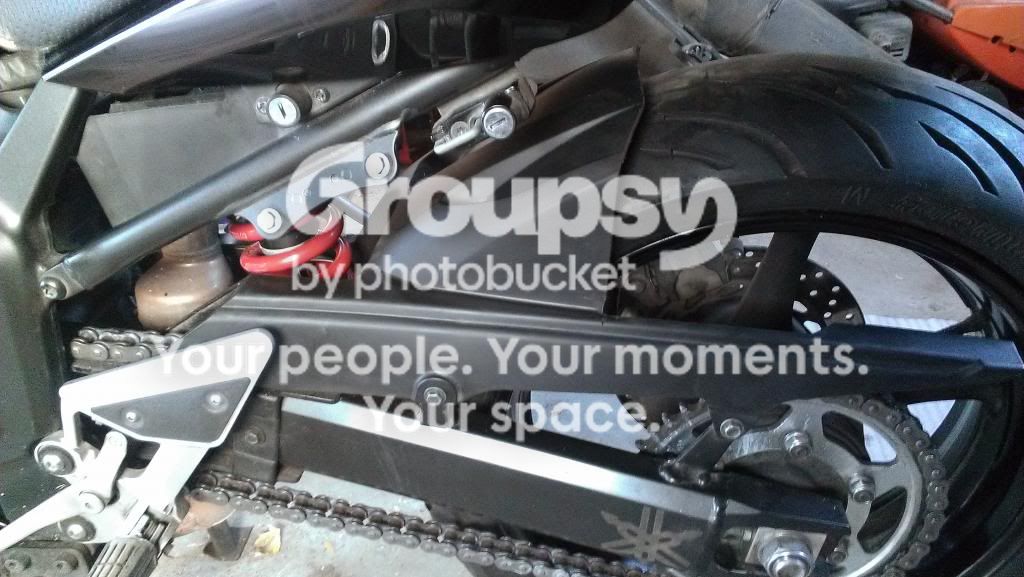

I mocked up a spacer out of wood .5" thick with a 3" diameter and found the numbers much better. With preload maxed, I was getting 7mm of static and 36mm of full sag so clearly the issue was the shorter spring and lack of preload. After shopping around for quite a while, looking into having a custom piece turned down, choking at the cost, then searching some more I eventually found some 2" ID x 3" OD machine bushings which were 1/8" thick. With 3 of these and the stock spacer I ended up a little less than .5" thick. Threw it back together and took a ride and it's definitely an improvement. The 'droop' I felt before is gone and although I haven't ridden it too hard yet, it seems to hold a line much better in turns. I was a little apprehensive about the damping but I thoroughly tested it on our pothole-laden streets and a few speed bumps and it feels good - rebound is a bit more harsh but hardly noticeable. Only thing I'm worried about is the static sag - most info I've read say it's not a big deal as long as you're close to stock. I know this thread has a serious lack of pics so here you go:
Difference between stock spring and Eibach (bottom perch is on the Eibach..idk why I left it on there..):
Eibach spring mounting up with spacers (wrapped valve body in black vinyl):
Installed on bike:
