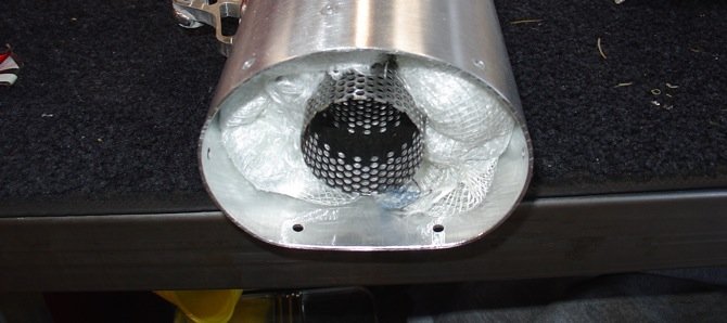

I stuffed my inner baffles with stainless steel exhaust packing and wrapped the baffles with fibre glass woven matting, that worked really well

I don't think I have the patience for that but out of curiosity, how much or how little do you put in and when does it start affecting back pressure and performance of the engine?
I believe most exhausts look like in the pics attached; you're not stuffing the pipe, but the space between the pipe and the outer "coat"concept_muffler_explosion_muffler_with_diffuser_1.jpg

I didnt pack it tightly It is enough to disrupt the exhaust flow, but not impede the flow and create loads of Back pressure. I havnt measured it, but compared to the tight packing of the complete can, I figure its about 5-10% density. The packing in the main part of the cans is really really dense! more than you do by hand I would think

When I was starting to look at the noise issue I undid the cap on one can( drilled out the rivets) and found that the packing is incredibly tight and I found that it was hardly scorched even tho I had been running them for 18 months and I bought them from another member who had them on for a year.
Thats why I went down the road of filling the baffle. I read quite a bit about exhausts and how they work- its all about disrupting the flow apparently
