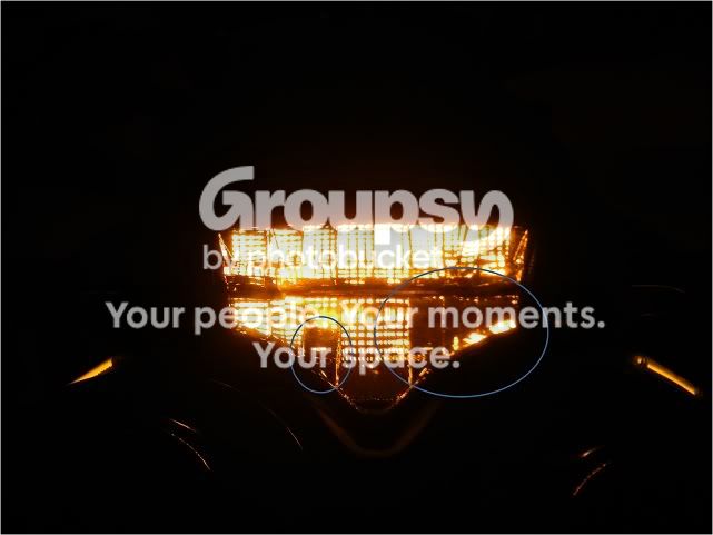

Just installed mine, which is clear, and it has a similar problem. I'm extremely disappointed at the poor quality control as this doesn't seem to be an isolated issue. I emailed them with photos so I'll see what they say.
Also installed mine just now. Sue, given we both bought it recently, it should be from the same batch. I do have the same issue as you but it less prominent.
Depending on the vertical angle that you see it from the 'dark area' is either on top or the bottom. Seen from the level of a car driver, there isn't that much of a dark area. Seen from the level of a truck driver, then the issue shows up.

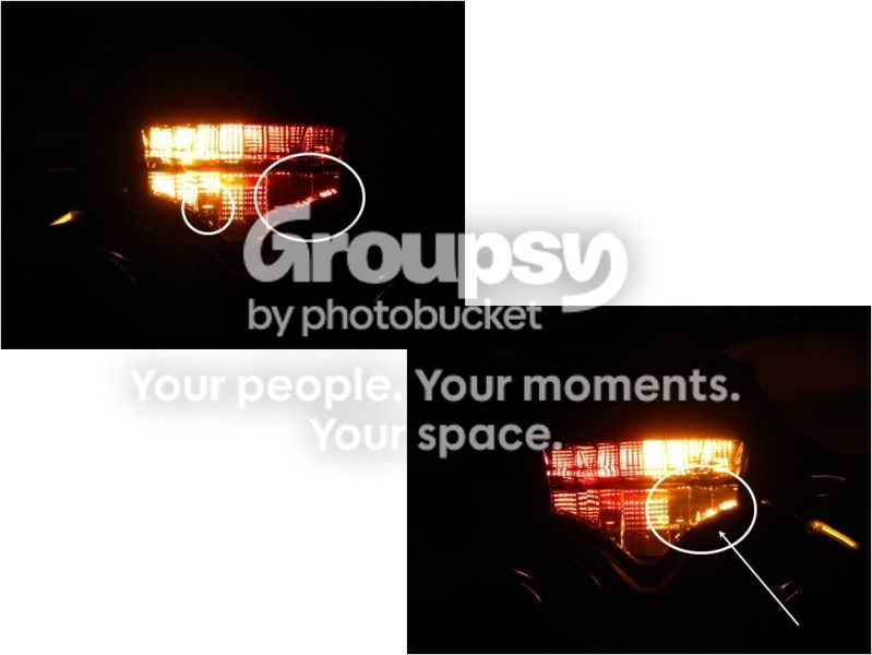

There are two pictures showing the light from two different angles. I'm a bit disappointed given my previous cheap led tail light seems brighter but I am still keeping it. It does project light to a wider angle than my previous one which was pretty much straight on. I also like the flashing stop light.

The cause of the issue of asymmetric light output seems to be fairly obvious though. Looking at the placement of the LEDs to the reflectors, you can see that the placement is just slightly off from left to right.
The reflectors are curved so as to focus most of the light towards a car driver level. If you get outside of that specific zone, then you start seeing dark areas depending on the placement of the LEDs.
Either it is the board containing the LEDs that's not placed properly or the reflectors are asymmetric. In either case it's a quality issue.

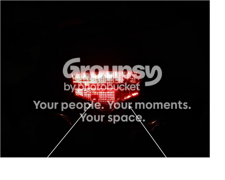

For comparison's sake, here is my old tail light which I bought on eBay last summer. As you can see it's bright and that's on top of a very dark smoked screen. However it's less impressive looking slightly from the side and it doesn't have the flashing stop light.

Great SHOT! Looks like a tiny aliment issue leads to focal issues. Moving the LED on the PCBA or moving the whole PCBA would change the light output substantially....
