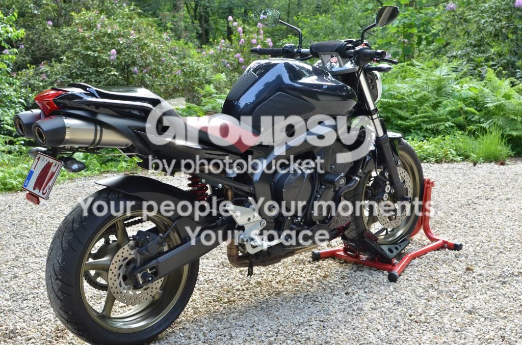

Stephen ingham
Oct 17, 2013
west yorkshire
sorry to hijack your post but have to say i love the black and red seat, is that year specific, i have a 2004 fz6 and would love something like that....
Carlos840
Jul 8, 2013
734
Belgium
The seat came stock on some edition of the naked FZ6 in europe, i think the color combo was called carbon, it had the red and black seat, grey tank and gold rims... I have seen a few on ebay, but it might be cheaper to get a custom cover made....
