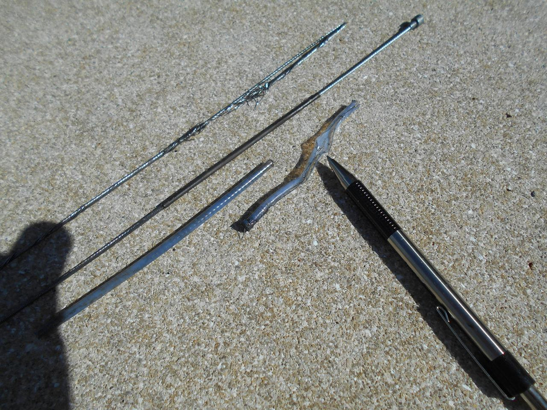

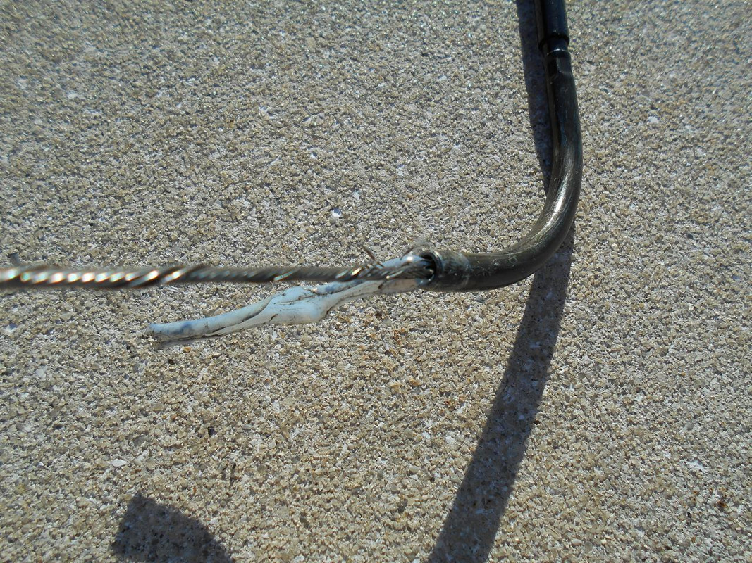

How many miles on the bike? I ask in that I found my clutch cable ( about 20,000 miles and ALWAYS LUBED) ready to break while doing regular maintenance. You could not see any broken strands (till I cut it apart), but could feel it (while lubing) was NOT smooth.
After lubing, simply try moving the cable back and forth by hand, it should be nice and smooth (un-like below)

I was very surprised and mine WAS maintained.
Just when you lube the cable, simply disconnect it from both ends and makes sure it slides easily with no binding...
