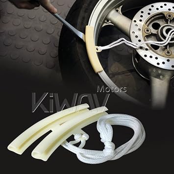

I've mounted 6 sets of tires on mine. The nylon mojo blocks are key as is a nylon tipped tool like the Mojo lever or NoMar. Get yourself some rim protectors as well as they really help when initially getting the de-mount bar in there to prevent rim damage.
