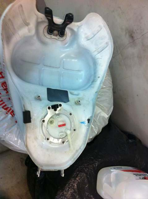

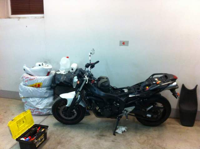

this morning I noticed strong fuel smell in garage, though that somebody did smth wrong with gasoline, but eventually in evening I understood that thats my fizzer.
Took the tank of and there it was, looks like hose going from pump to fuel rail is leaking. it is not broken, but perhaps the connection/ o-ring/ whatever failed. Has anybody experienced this? is there any fix or a have to change, most probably expensive, fuel hose?
what is more, I am afraid to ride as it drips on cables and can cause fire :eek:
I hope the best with finding the leak in your tank and fixing it.

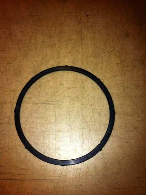

Hi, thanks for nice words. Case turned out to be yamaha classic - fuel pump seal/ gasket. Part is not available separatelly, so I tried to find alternative part in automotive shop. Trial failed. There is no such a big o-rings. Fixed with black silicone used in engine rebuilds and same old gasket. There is no leak at this point, will see how it looks in the morning ;)
It is hard to see in pic of gasket, but there is a dent and seal is broken, looks like bad fitting in factory.

They do make that O-ring, available separatly, and per Yamaha, its supposed to be replaced when replacing the pump.
Actually I have the old one when I last changed out my tank. Holler if yours continues to leak and you can't order one...

I've never seen any Silicone product meant for direct assault by gasoline. Please for your own safety, don't even bother filling it!
I would do what ever you can to correct the pinch or what ever damage you found. Is it the tank, the plastic, or the aluminum clamping plate that have the dent?
Perhaps try a macro picture?
Thanks Scott! And yes I will be ordering these and change my temporary solution, but at this point - it just works :)
