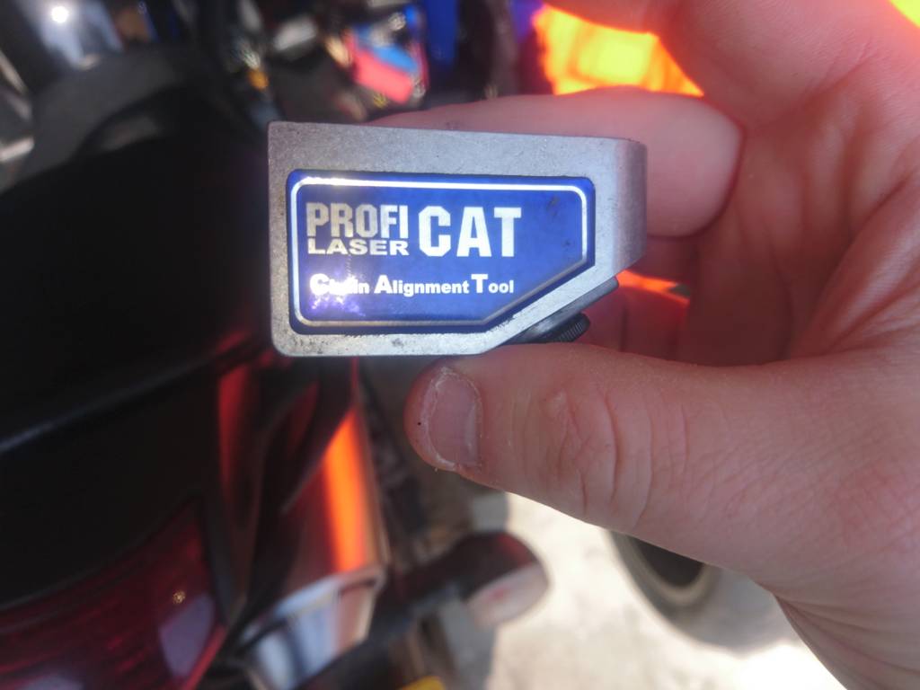

Personally I prefer using a chain laser: It's just quicker and easier than the string method, but I'm doing fairly regular chain adjustments due to milage, new tyres, regular maintenance etc.

What brand/type lazer are you using?

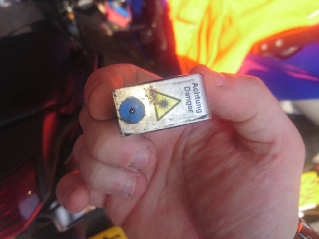

This little dohicky:
It cost less than £10 from a bike show. Brilliant bit of kit. Just offer it up to the rear sprocket, check it's aim at the rear of the chain, aim it forward and see if it hits the same spot.

If I stumble upon laser tool, I'd give it a shot...

I ordered one of these lasers and it arrived yesterday. I checked my chain, and it was indeed a little bit off. I seem to have this same "slips slightly on the right hand side when I torque it up again" problem, even without removing the axle, as I'd get things lined up dead on according to the laser, and then find that things had moved slightly upon snugging things up. I had to do everything about four times before I decided it was close enough, and even then, the laser hits a spot very slightly to the right of where it hits in the rear, in the front. I think it's probably close enough, though, and is definitely better than it was.
