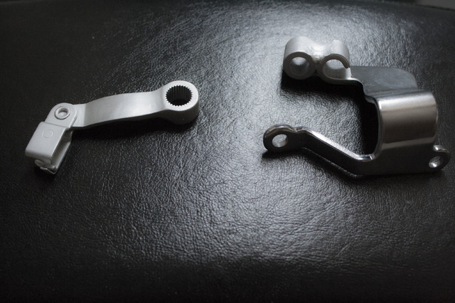

yup came today thanks very much! they look great! I have some welding experience and considered doing this myself before I found your thread, and I am very glad I had someone with your expertese do it instead... the weld joint is so much better than what I could have done and even the factory original its not even funny!

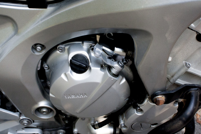

I modified the lever and the bracket myself with the help of this topic.
I put it on today and feeling is great. I should have done this before.
Extension is 10mm without adjustment holes.
I painted it grey for a different look :)
Here are some pictures:

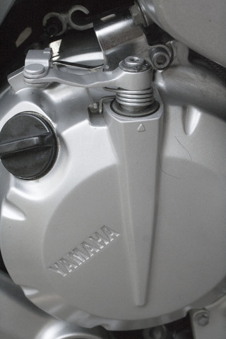

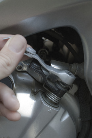

I received the new levers in the mail last night. Couldn't wait, so I took the morning off from work to install and go for a test ride. Installation was pretty simple and the new cutout notch worked great. Great craftmanship KN!
Rode on one of the steepest hills in San Francisco. Came to a stop and feathered the trottle to test out the new friction zone. What a HUGE difference. I went from what felt like a millimeter of friction zone to what now feels like 2 inches! Seriously amazing.
Just one problem....I just bought adjustable levers a month ago and now the pull is so silky smooth that I can finally get shorty levers. Before I had to use all 4 fingers to get enough leverage. Now two fingers works without much effort.

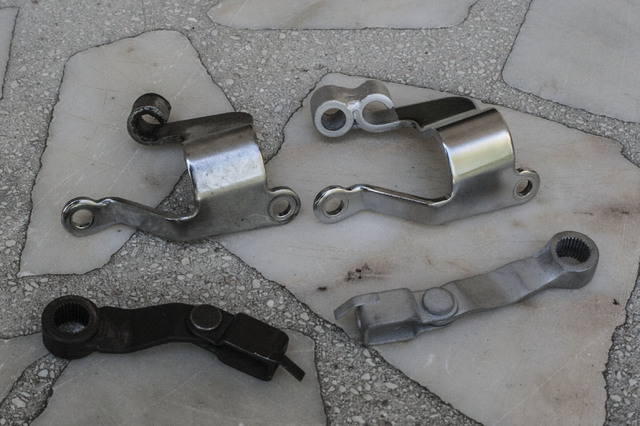

Has everyone else received their levers yet? I'd like to get these cores back soon, I have quite a queue stacking up behind you :rockon:
I got my parts, installed them (they're like Frosted Flakes...they’re grrrrreat!) but I went to send them out and USPS won't take parcel post online anymore so I have to go the the post office...which is way out to the way.
I should be able to make it there this week, but they're already packaged and addressed!
