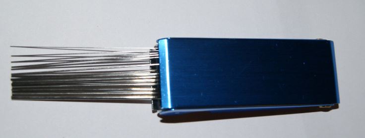

I use a sonic cleaner first, then spray, then jet cleaning needles (cheap on E Bay)
