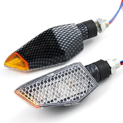

I've had a few bikes with LED aftermarket lights on them and these are the best I've had. The only brighter ones are very expensive in comparison. I've had these for almost a year and I'm very happy with them. If you have a Cycle Gear store near you they may have them in stock as they were for me. They, like so many products are made in china and sold under different names Some have different black plastic, chrome or CF look finish. They are worth the money, are a nice style and bright!
SPEEDMETAL Parts & Accessories - LED Angle Lights - Cycle Gear
Also you may want to get an electronic flasher instead of the OEM flasher because the flash raate will change when you switch to LED from incandescent turn signals. Here's a link to one that costs $8.95 and works great! LF1-S-FLAT Super Bright LEDs - Electronic LED Flashers Specifications
Mine are just like these but not the CF look...:)

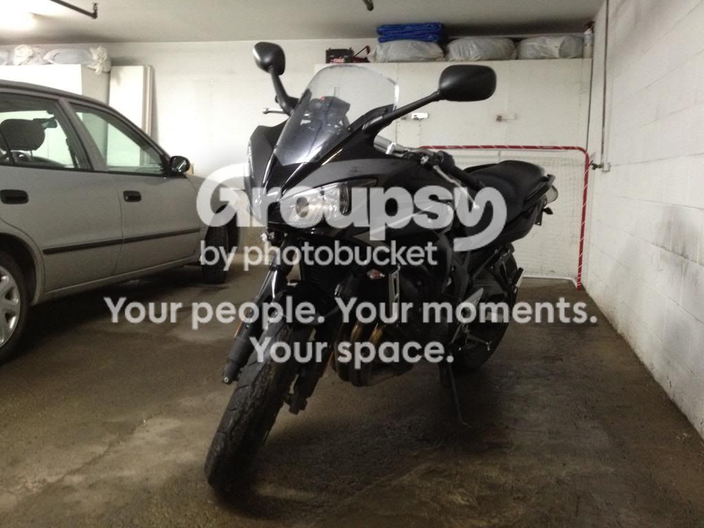

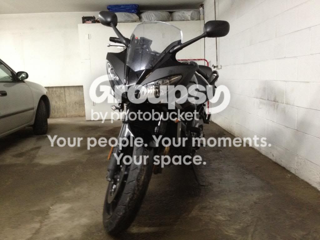

I picked the same ones as Motogiro. I think they look good and wanted something bright too. Also wanted indicators than could be seen from the side and these are visible from the side as well.
I just took a couple of pics in the parking lot, not the best pictures but you get the idea. I also included a pic of the indicators I had before were shaded LEDs, not very bright.

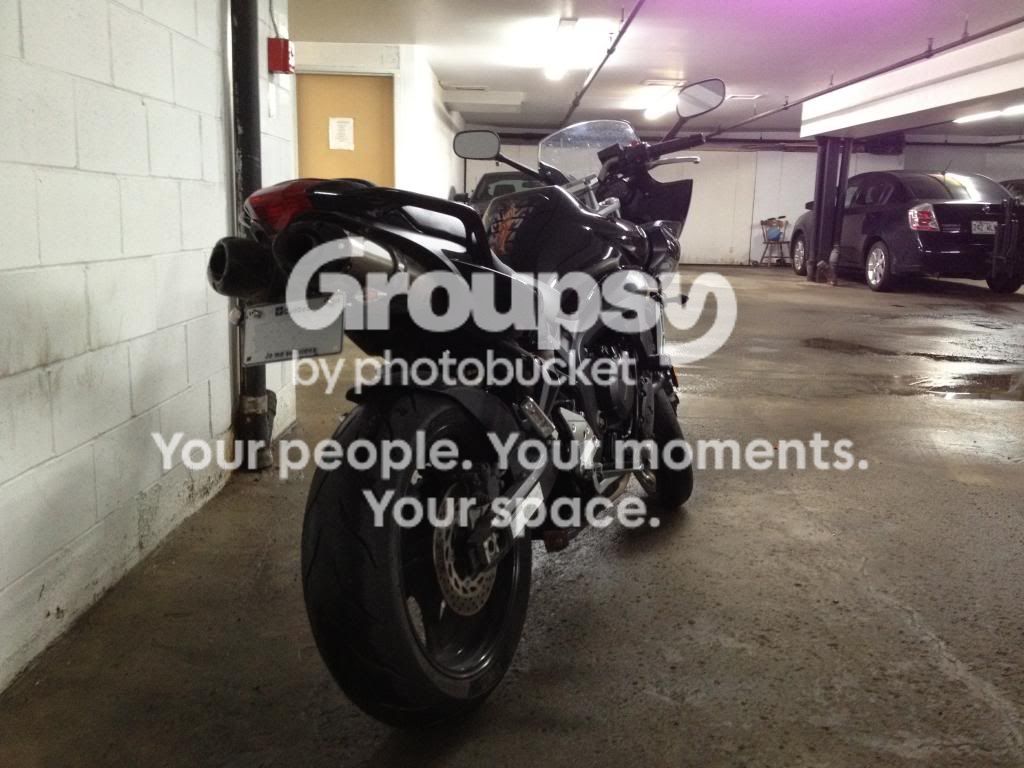

After almost a year trying to figure out which one to put on, finally decided to pull the trigger on those. Really happy with the result specially for 30$ shipped on eBay, just wish they would be a little bigger, but oh well !! Sorry for the crappy pics and dirty bike.
