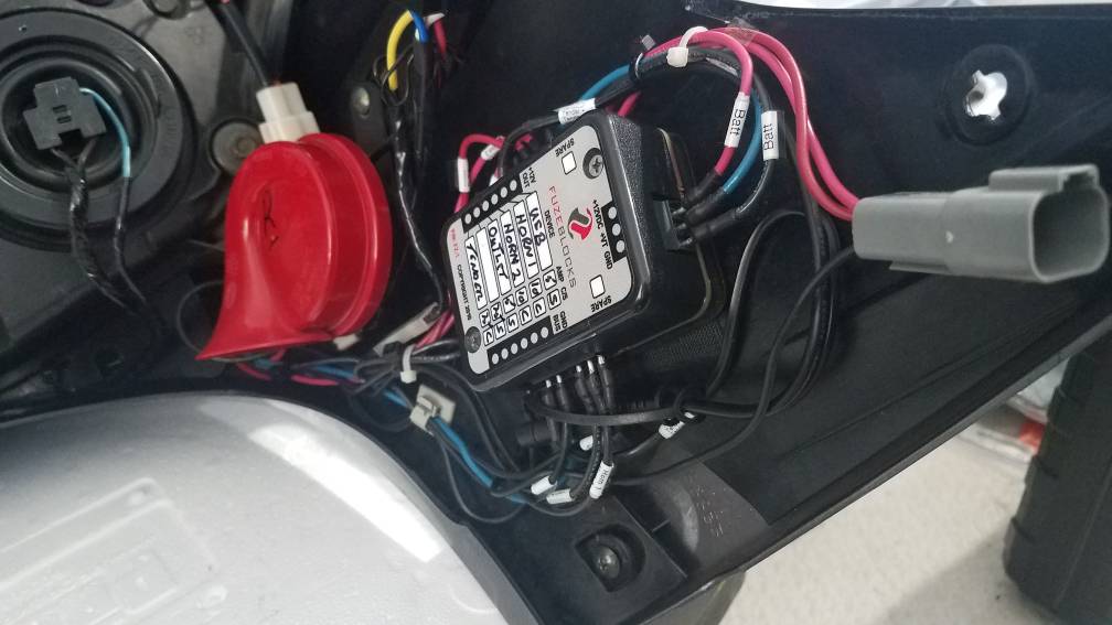

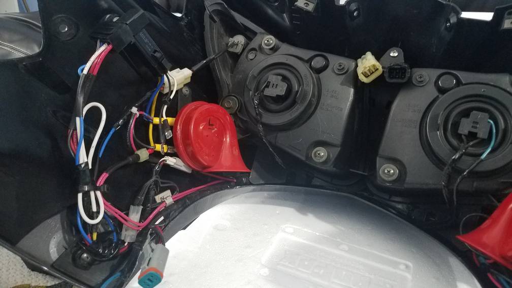

Finally neatened up the wiring in the nose. Added 2 waterproof connectors to interface with the chassis harness, installed pair of hella horns, and used pin terminals to bring everything into my Fuzeblocks FZ1 pdu. Time to put it back together and ride.
Sent from my SM-G930V using Tapatalk
Thanks.
That is the FZ1 from Fuzeblocks. It is a PDU that gives me 6 individually-fused connections for power with each connection configurable for constant or switched power out. I rewired everything so that it is fed from 1 of 2 water proof connectors. So now I can remove the cowl by disconnecting 4 connectors. Nice and easy. Additionally I labeled each lead for that 2 months from now I avoid the head scratching that comes from thinking I will remember what I did over the winter.
