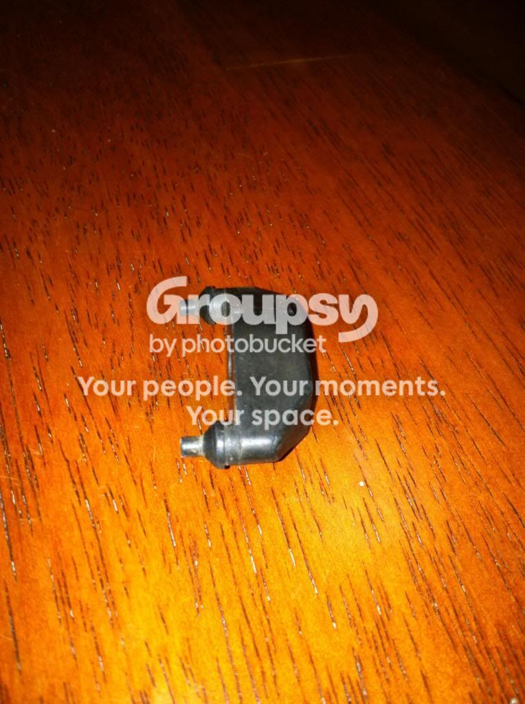

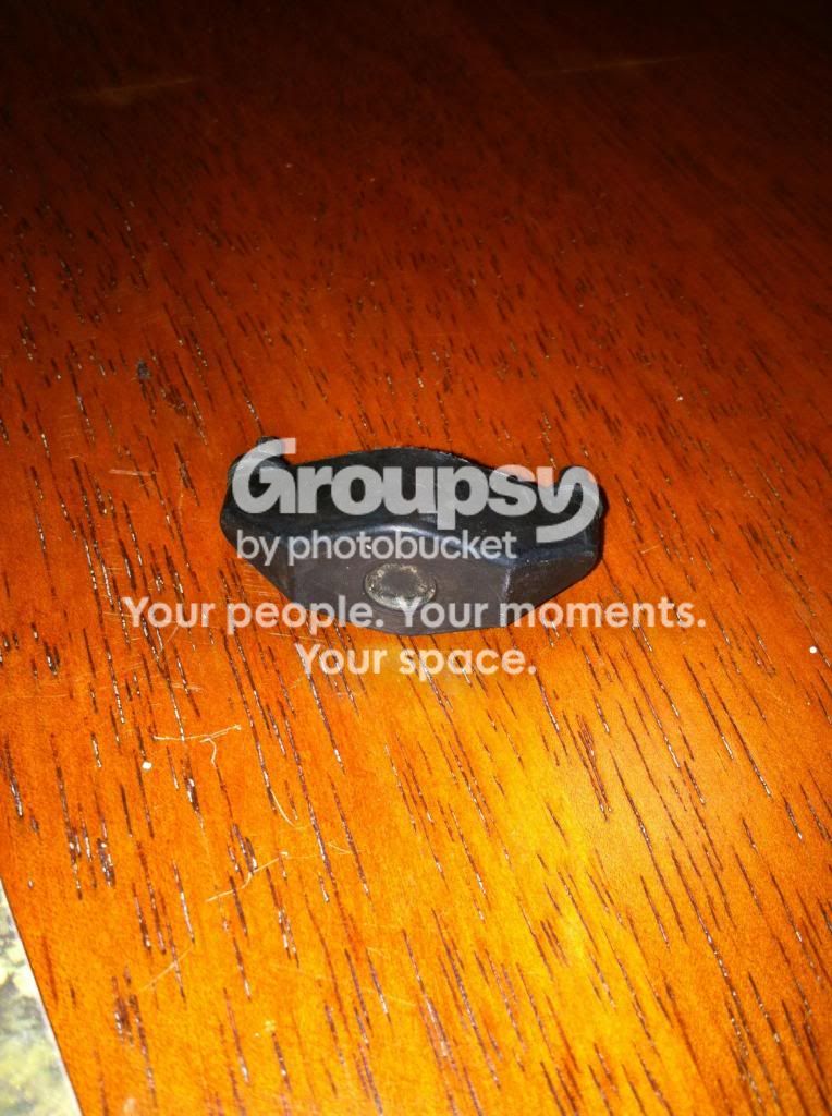

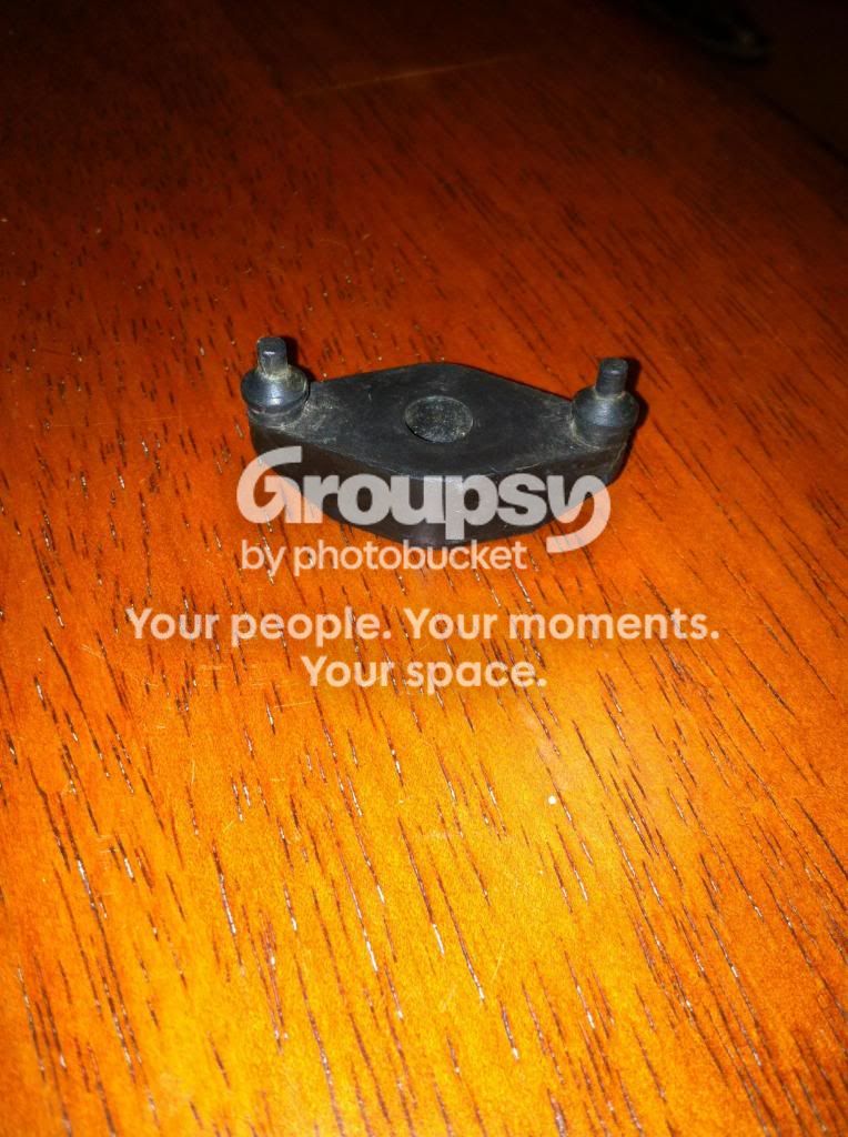

Hello all, just bought my first bike a few weeks back. My experience is riding a dirt bike one time lol. Only rode a few times so far...now that the intro is out of the way...I dropped the bike starting out in wet grass right after we got it off the trailor:eek:
Anyway it snapped the mirror off (replaced it) and we found this rubber piece lying in the grass as well. Being new to bikes, I don't have the slightest clue where it goes. Below is a few pics and a pic of my new to me bike

I don't think that part came from your bike but I've never had mine completely apart. There is nothing under the tank or in the fairing of that nature but I could be mistaken.

Goes next to the seat latch, please excuse the dirt... :ban:
