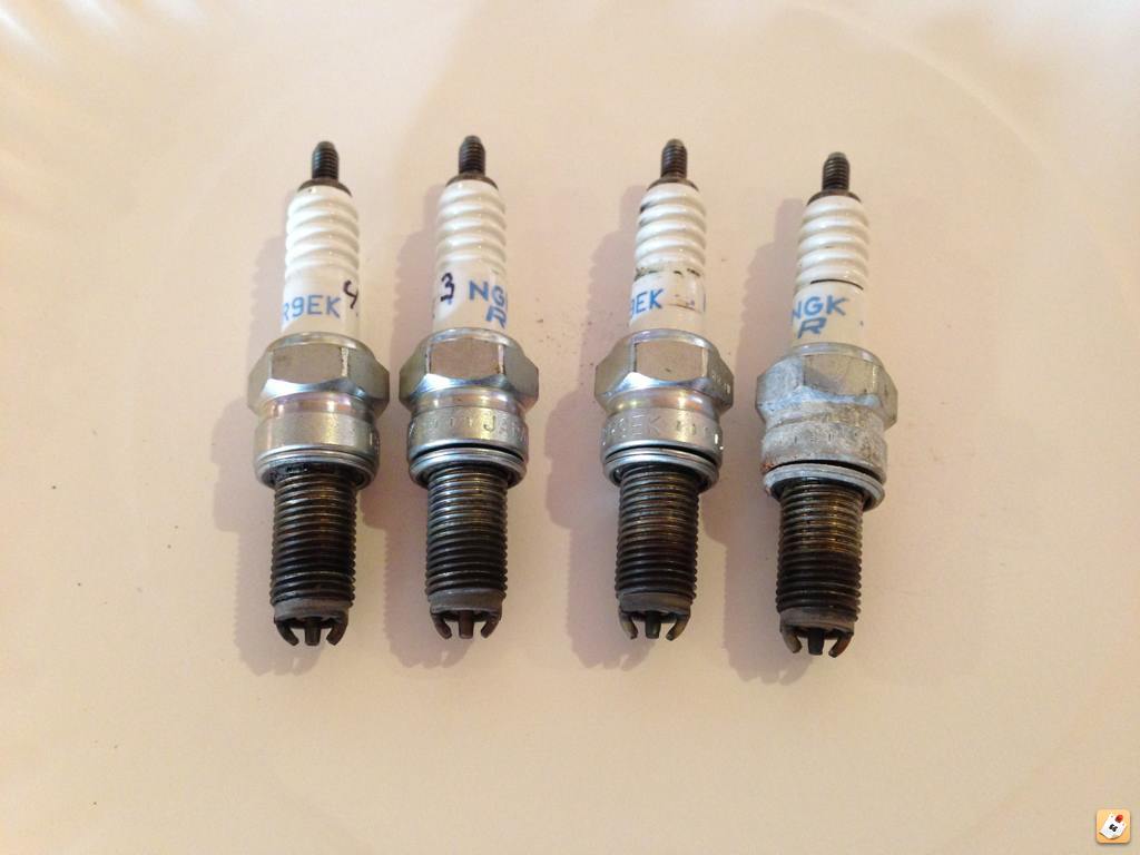

Here are my spark plugs. Gaps are over .03 on all, there is some corrosion on plug 1 (right), and there was a trail left from arcing by on plug 2. No wonder I had bad vibes lately!
Well, back to work on #1!

How many miles and what are you putting back in? You can see the gap really opened up from wear! Its gonna feel like a new bike!
PS - drop the two bolts out of the radiator just be careful of the cooling fins and let it settle down. Makes it much easier!
12,531
1,176
Re: A cure for bad vibrations, spark plug caps!!
Yep, wear will open the gaps.
IMO, I'd set the gap at the smaller end of spec's on the new plugs.
Also, some dilectric grease on the spark plug caps (especially aound the valve cover) will make installation MUCH easier and you'll actually hear the caps snap onto the plugs.
That arcing looks like the #2 cap wasn't fully seated on the plug.
Some moisture was getting in there as indicated by the outside corrosion on #1 plug. That dilectric grease should help that as well keeping water from sneaking down past the caps ..
Dropping the radiator helped a ton for accessing cylinder 1!
They haven't been changed in the two years I've owned it. just looked looked at the service records from the previous owner, they were done at 12.5k miles, 3.5 years ago. Bike currently has between 23k and 24k.
I'll be putting iridiums in after I pick some up today, along with a spark plug gapper. Can't wait to ride it hopefully feel the smoothness again!

With the iridiums, you HAVE TO USE a wire gauge style gapper for checking and be very, very gentle with the end. IF the gap needs tightening (or loosening) DO NOT force the ground elctrode with the gauge touching the tip. Adjust STRICTLY BY bending the ground strap.
BTW, when I replaced mine with iridiums, 3 were dead on with the gap, one plug was .001 different (I didn't screw with it)

Interesting; 10k and the plugs look pretty warn. I don't see where the cap was loose on #2 (arcing). Am I missing something?
FWIW: if the seal above the main boot is pushed on too far it will prevent the cap from seating fully on the plug. It is suggested you move it up the cap, shove the cap firmly onto the plug while listening and feeling the cap click click click onto to the plug. Once down completely, now seat the round biscuit to stop water and dirt intrusion.
This is just me but adding any grease of any kind at the top of the boot is going to hold debris attracting dirt. JMO but I'd rather not have a blob dirt up there myself.

The arcing trace was on the side of the plug in the picture, can't really see it. I couldn't get both the gap wear and that trace in the same pic.
Putting them back in, that is exactly what I did. Put some di-electric grease in the cap, pushed on the spark plug as much as I could while listening to the clicks, then made sure that rubber biscuit was covering/sealing the holes.
Took it for a quick spin and took it through the RPM range, a LOT less vibes in the middle and upper RPMs. Now, when I get time, I'll do a TB sync.
