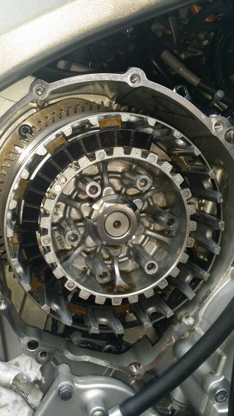

I got myself a clutch surprise the other day, when I picked down the clutch it turned I've got a friction plate explosion! Just fishing the remaining pices in the pil pan!
Now I ordered a new kevlar race clutch kit since the original doesn't like wheeles! Maybe a race clutch like this could be interesting for ur project!?
Really price worthy as well! I could reply how it feels when the clutch kit is on its seat! =)
