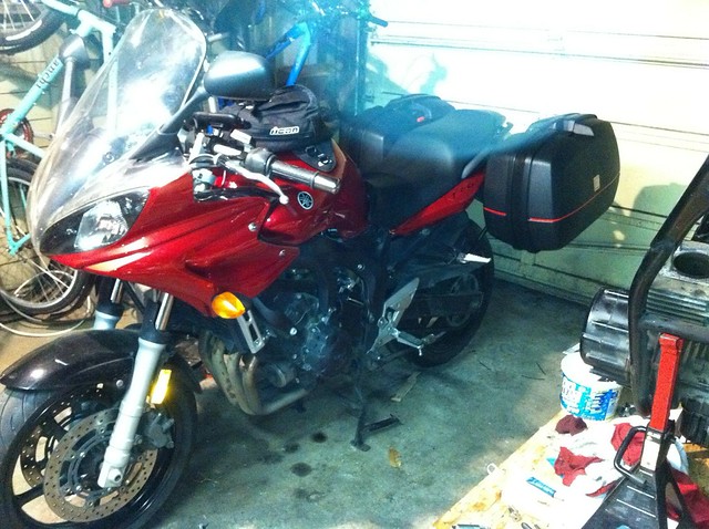

The short and sweet: Givi vs Sw-motech racks (both top and side cases). Which is better quality and more likely to handle the fact that I seem to like overloading things?
The details (I wrote the rest of this before I decided some of you might prefer I get to the point hence the above. You can skip everything after here if you want):
For my Ninja 250 I had the Sw-motech top rack with a 45 liter Givi case (forget the model number but its rebranded "Simply" or something like that). In regards to mounting it I didnt have much of a choice because Givi doesn't make a top rack for the little Ninja. Im happy I bought it though because its been the best thing I could have ever added to my bike and am making sure to bring the case over to my new (to me) 2006 FZ6.
The Sw-motech on the Ninja seems to be of great quality and I've overloaded it many times with only the once every like 6 months retightening of the screws. Because of this I've gone and claimed one of the top racks that Twisted Throttle has on the way in. Lately though because of my upcoming cross country roadtrip I've been thinking of adding side cases too (I have soft saddle bags but never really did like them and figure I can attempt to resell them if I go hard). With just the top case I'm willing to pay the extra for the sw-motech because I know I'll get the good quality and its worth it to me but now that I'm considering both top and side its pretty expensive for just racks and buying all Givi brand racks would save me quite a bit of money.
Are the Sw-motech racks really that much better quality? Do they take more weight than the Givi's or is it quite the opposite? Im sure I could cancel my order with Twisted Throttle and get the Givi brand for both top and side. Given my long trip ahead of me it would be a really bad thing if any of my cases decided to break off in the middle of nowhere.
So durability and overloading my biggest concerns are the Sw-motech worth the extra money or not?
I will be carrying some of my tools with me which will definitely add to the weight on my trip and I'm also going to be away from home for at least 2 to 3 months so I'll want to have quite a bit of things on me from clothes to my laptop or at minimum my tablet (prefer to bring laptop though) and even some camping gear. So much I'm spending though in getting ready for the trip (and my recent purchase of the FZ6 when I was spending money prepping my Ninja for the journey and now having to prep the FZ6 instead) so I'm even wondering if I should bother with buying the side cases at all, I did okay with the saddlebags on my Florida trip last summer they just didn't thrill me and I hated that they sag so much and don't look anywhere as nice as hard cases. It was kind of annoying to keep taking them off every time I stepped away from my bike so the added security of hard cases is the other seller for me.

I know I am going through much of the same debate right now! From what I have dug up so far if you are willing to spend the money for the quality get the SW-Motech, it also has the advantage of being able to be quickly removed for the bike when your just cruising around town. I just used my top case and tank bag for a weekend trip to some flat track races and I wish I woud of had some other bags with me as far as room goes. So if I were you I would probably go with the SW-Motech since you are planning on overloadin the suckers!
One thing to remember though is if your bike has aftermarket exhaust or a fender eliminator the racks may not work, that is my dilemma right now(besides not really having the money to do this), is figuring out which side racks will work if I get an aftermarket exhaust. Good Luck to you!

i just installed the givi side and top racks. They seem very good quality. I have sat on the racks and at ~200 lbs i felt comfortable that they would not break under my weight. This weekend i also strapped a good 45-50 lbs of crap on it in a stuff sack and bunged it to the rack. I rode around for 2 hours running errands and such and had no problem.

I just installed side racks only for Givi E45 cases. I chose not to have a trunk.
I've been very happy with them and they seem very solid. It would be hard to remove the racks themselves quickly but I can't imagine the release of the monokey racks being any simpler. Just twist the key and press the button and they are off.
I have no experience with the Motech, but I'm very happy with my Givi cases so far.

ive found the givi fz351 top-case carrier great, givi recommends 10kg but ive put 12kg and it handled well, no stress points, no experience with Sw-motech racks, so cant comment
