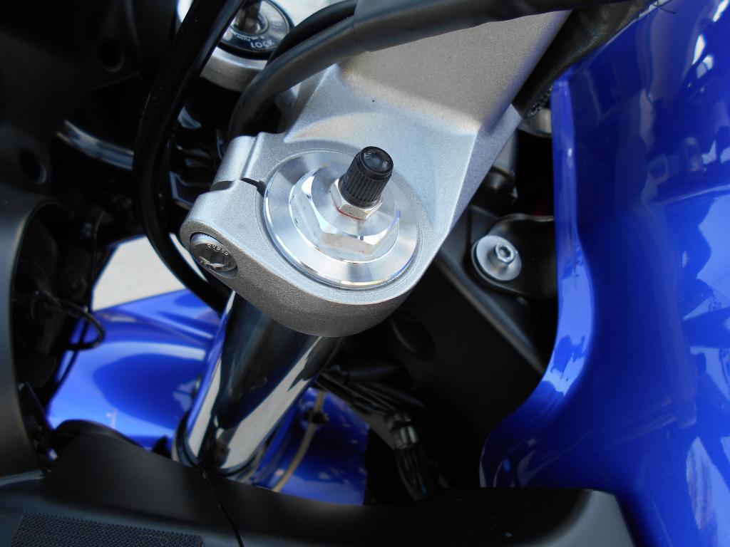

For infinitely adjustable pre-load and fork compression rate:
I've had this set up for well over 3 years (stock springs still installed) and am very happy with the set up. About 15PSI in each leg gets rid of the excessive sag and tightens up the compression rate.
Maybe once a year, I'll have to add 2 PSI, no leaks from the seals (30,000 miles currently)..
Do you put regular air in? Any change with temps?
12,531
1,176
Regular air, (very little as the space is very tight).
Re change in temps, no, not all.
It's just a very small volume of air.
20PSI is way too firm, 14-16 works great..
Schrader valves were from old MX tubes, fully threaded..
The only investment was sealer..
Gotcha...didn't think about volume. Was going to suggest nitrogen would fix that issue....doesn't react to temp changes like air. For the fork caps, I'm guessing you drilled/tapped yourself?
Loosing such a small amount of air over a year, really isn't an issue. Top off as needed when topping off the bike tires. You do need a digital air gauge to get them within .5lbs each side.
For the caps, I drilled them (on a drill press, but not necessary) with just enough room to slip in the valve.. No tapping for threads needed... As I re-call, I used Yamabond case sealer (#4) to seal up the valve to the cap. Any good sealer would work fine..
So no tapping but was the hole slightly smaller for a press fit or does the sealer do all the work?
