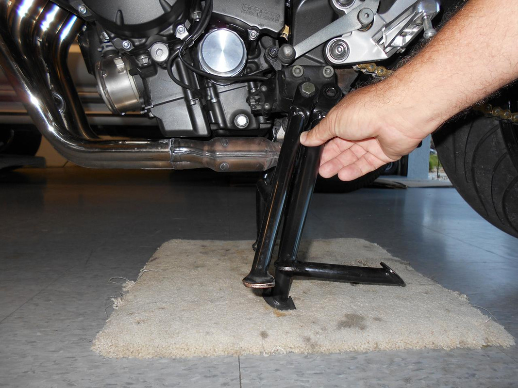

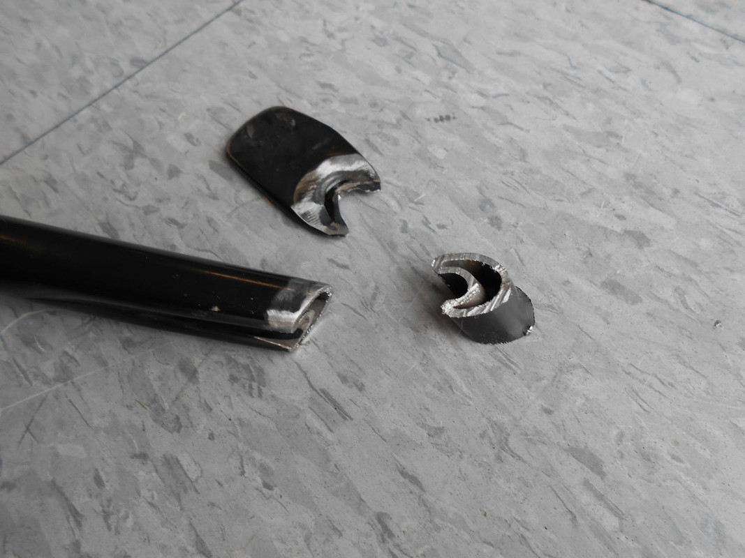

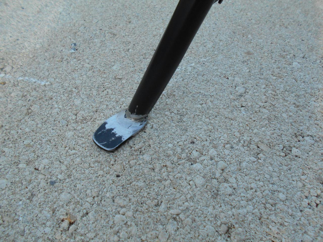

Pic's below show one side stand I shortened and welded. Cutting the shaft parallel with the base keeps EVERYTHING lined up, just shorter. The angle at the head is un-touched, spring tension un-touched, etc.
What I cut off at the bottom (about 3/4", prepped for MIG welding) :
Welded the foot back on and cleaned up:
Shortened stand compared to my stock side stand:
