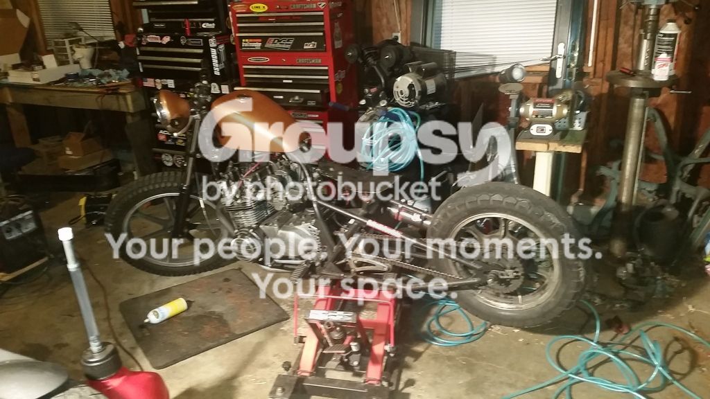

No your right not much rust compared to what Im used to working on... here are some pictures of current projects. . Like I said earlier Im in my 20s but stuck wrenching in the 70's and eary 80s.

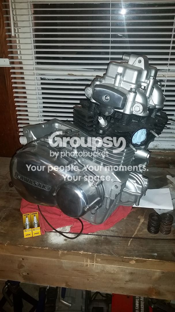

My daily. Kz650 with 750 jugs and pistons. Decked snd Ported 650 head for a healthy compression bump. gpz hot cams.. soon to be kick only to save some lbs. Just gotta wait on my starter plug. Stretched 12 lowered 3. Hardtailed. Shes my dirty surprise...
For a pretty picture. My wifes motor kz400 going into a custom cafe racer.
Rebuilding an 81 xs750 right now as well for a friend.... gotta finnish this fz before I pick up another project
its a beer and vape break.. figured I would shoot out some pics

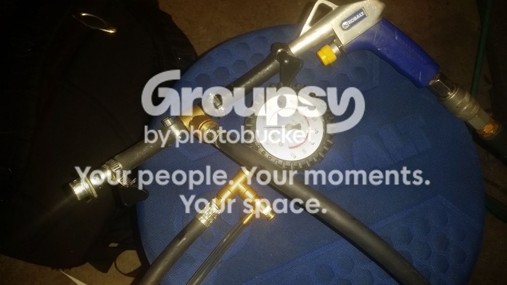

If you have a compressor and small tank, just set air compressor P/R to 35 and verify with your gauge. Or use a cage tire and wip ~ 30 to 40 psi pending on vehicle...

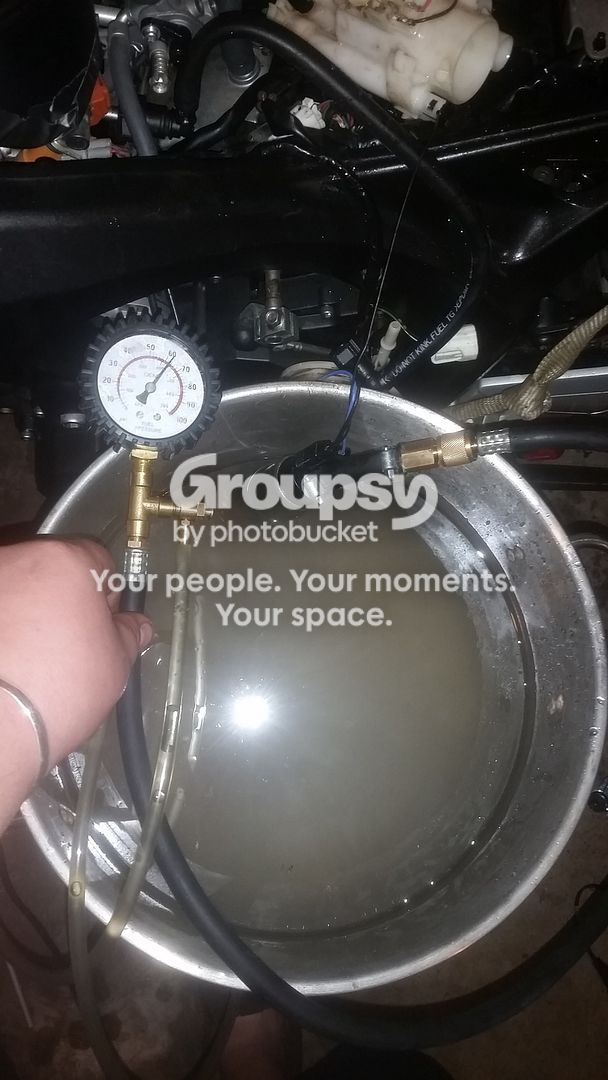

Fuel pump alone was way over 70psi and held above 60...
This was using stock wiring as well hoping to eliminate a voltage drop issue ( if one was present and keeping the pump from running correctly)
on to the fpr again
12,539
1,186
Pressure should be building up to 36PSI or so.
Seems the pump is easily getting you there(a good thing), and the regulator is dropping the pressure so the injectors don't have the pressure to make it into the cylinder(s).
