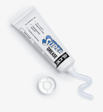

What ever you use to clean the coolant spill, be sure to rinse with plain old water as too many cleaners remain acidic and can continue their efforts even after you thought they were done. Assemble connectors with dialectric grease or Scott will come over and punish you! :BLAA:

Didn't get in too deep because of trying to get stuff sorted out for this work trip next week but I did double and triple check the side stand switch, kill switch, and tip over switch. Took the kill switch and side stand switch apart, cleaned them up best I could and did use dielectric grease on any plugs/connections. I also cycled each of them numerous times making sure they were working right and they performed as they should. I honestly don't feel like messing with it too much before I head out, I don't want to get into it deep and leave it unfinished if I can't find something out before I go because it would drive me nuts mentally knowing I left it incomplete. So I'll keep a eye on things and when I get back I guess I'm going to be going through the main harness checking all connections, wires, and grounds working my way from the reservoir out.

Alrighty dug into it and it looks as though some steam made it into the main ecu connector. There was evidence that there were a couple drops of water inside the plug and likely was causing a slight short. When I say evidenced I could see some corrosion, I recently picked up a small contact cleaner that has some very fine polishing paper and files for cleaning contacts on motor starters and contactors at work so I brought that home and went to town cleaning each pin and polishing it. Puts some electric grease on it and around the seal to hopefully prevent any moisture from getting in there in the future. I also checked out any other connection that looked like it could have gotten wet. Both on the ones on the fuel pump and the scotch lock that I tied into for the co mod also had some corrosion, so cleaned the ones for the pump, replaced the scotch lock then heat shrinked it (which I thought I did before but obviously I was wrong) and checked over some other stuff. Electrically all seems to be in order now but I have 2 other issues that are worrying me though.

With the contacts cleaned and greased, you should be fine there as well.
