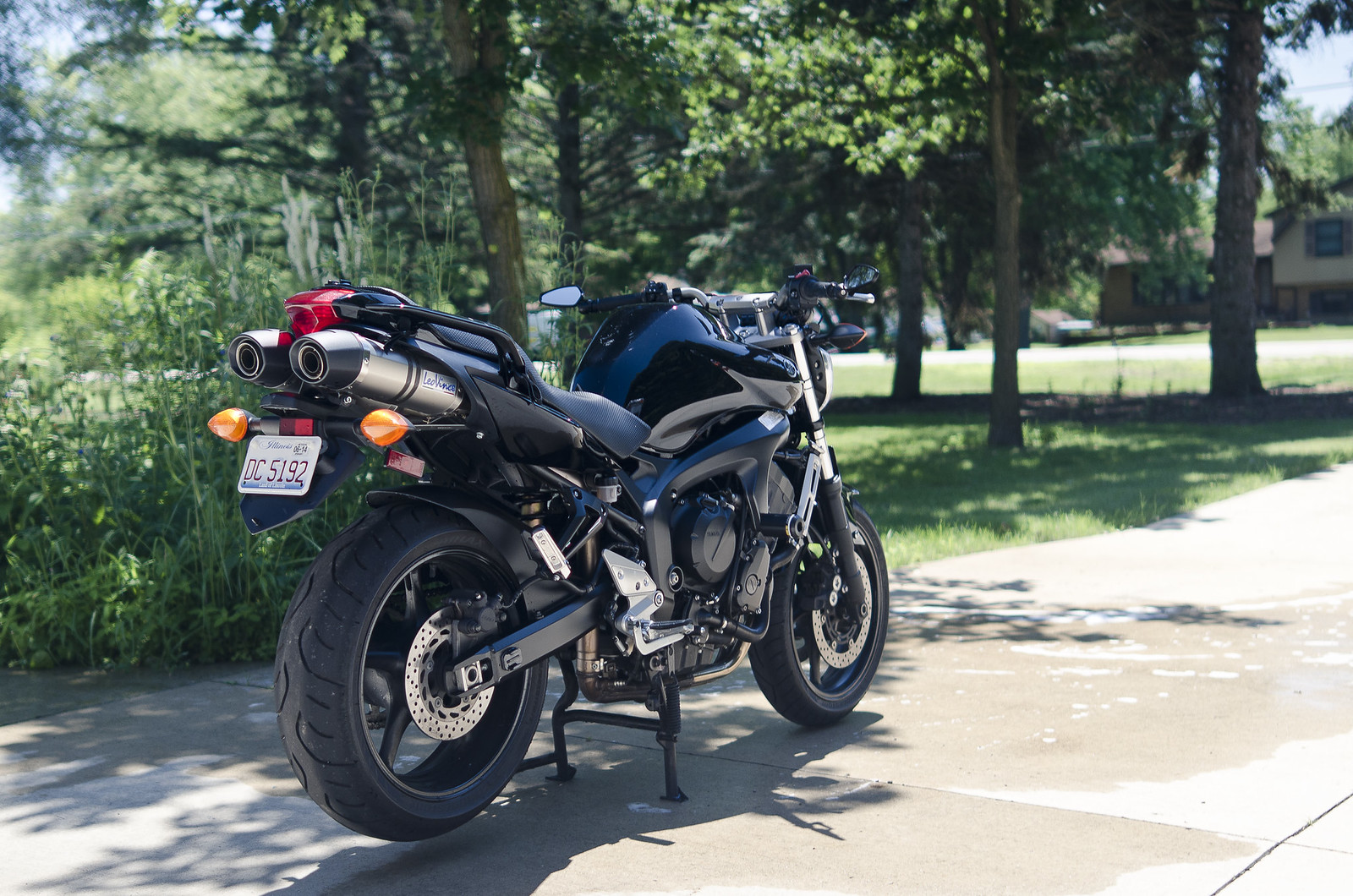

Here's a pic of the bike, its got Beowulf exhaust, belly pan, and now black mirrors, Puig screen and a 17 tooth front sprocket. :)
Look forward to any help you may have on getting the bottom end torque up.....
