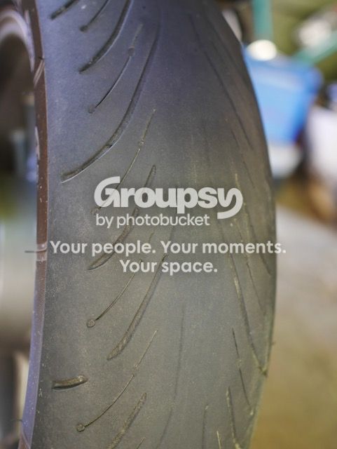

Ran a PR4 on the rear on the Tiger and managed 7K miles so for the cost difference between a T30 and PR4, 111.00 and 162.00 from American Motorcycle Tire, I'm going back to the T30.
Keep in mind that I run a 150/70 ZR17 and most of you run a larger size so your milage may vary.
