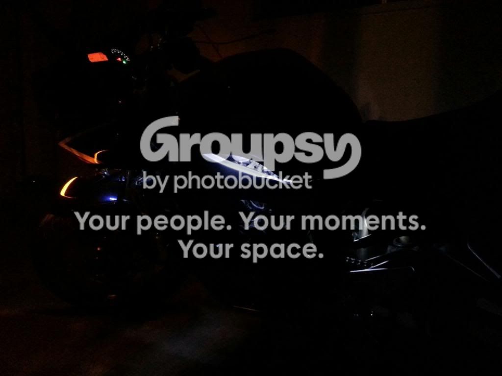

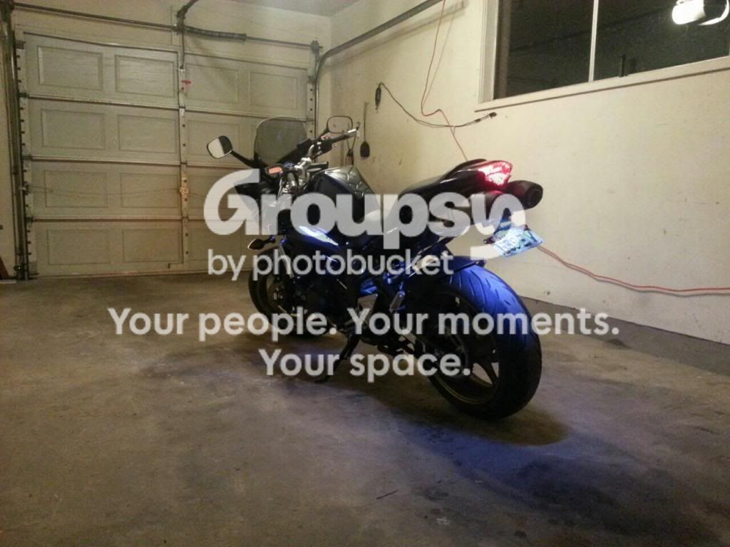

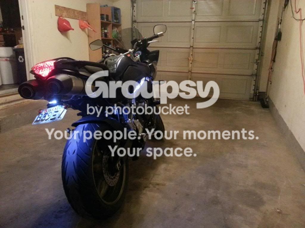

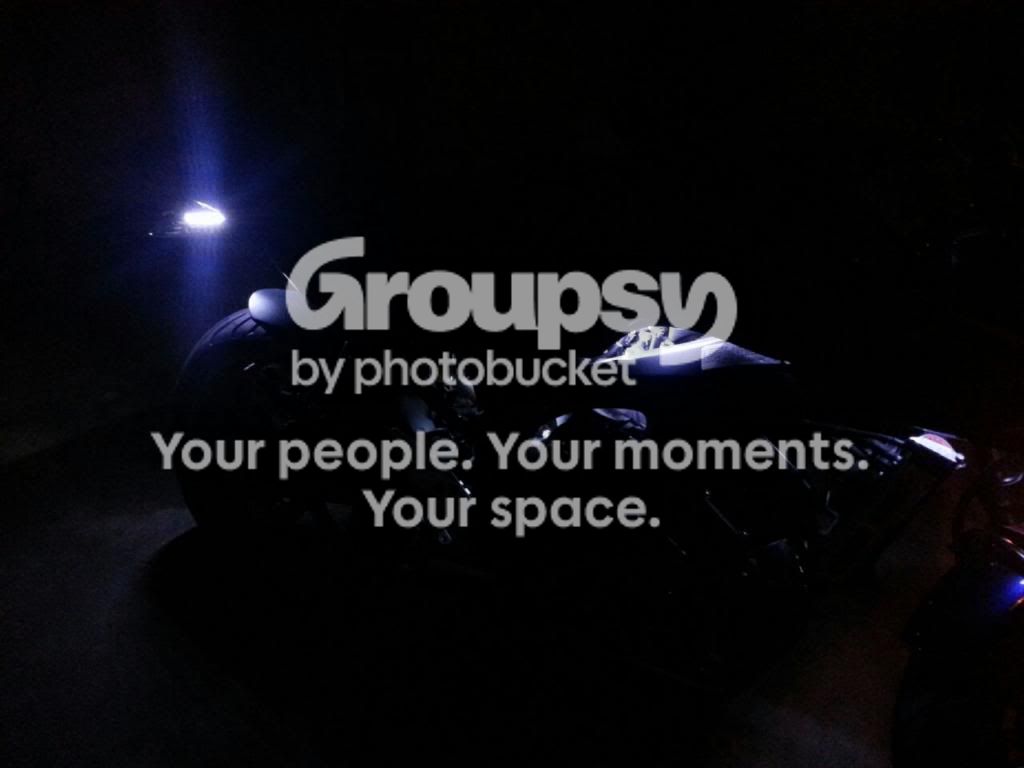

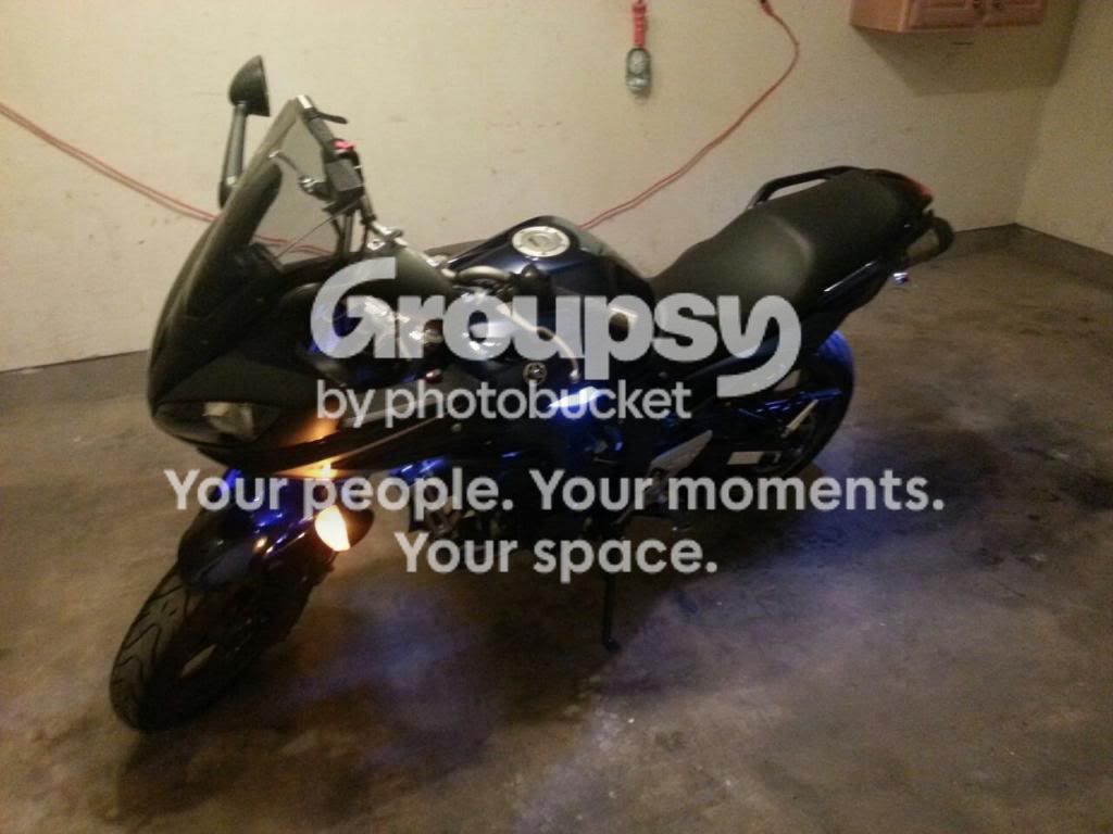

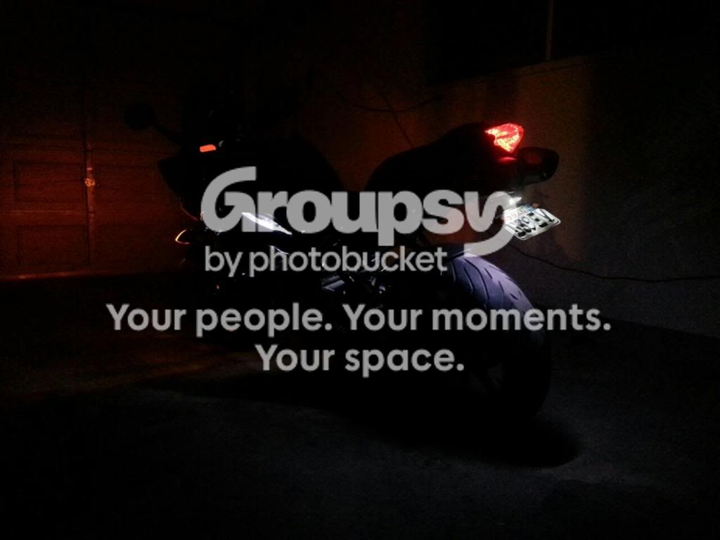

I decided to take Boneman's idea and use some very non-attention attracting white LED lights to help make me that much more visible at night. I have a total of 7 strips on the bike in various places.
All the strips are completely hidden from plain view and are not directly visible from the front or rear of the bike. In fact the only light that is visible from a side view is the one mounted on the back of the license plate, but it's clearly pointed down.
  • Two in the front fairing
  • Two mounted on the underside of the tank
  • Two mounted in front of the rear tire on the frame
  • One mounted on the rear of the license plate bracket
I connected all the lights to an LED switch on the left hand side of the fairing and ran the switch power using a mini 10A tap fuse (also called add-a-fuse) that is connected alongside the tail light fuse). Since I mounted some to the tank and front fairing, I add disconnects at these points. To help reduce wiring I spliced all the lights together in sets of two (minus the odd ball out on the license plate). When all was said and done it took probably at least 4-5 hours start to finish figuring everything out, getting various parts, mounting, and running wires.
I know this by far is not everyone's cup of tea, which is fine, but I decided it'd be a good idea add more lights that did not distract other drivers and especially were not gaudy (as I'd prefer to avoid unwanted attention). My bike now has a subtle under glow that I feel really adds to it's personality.
