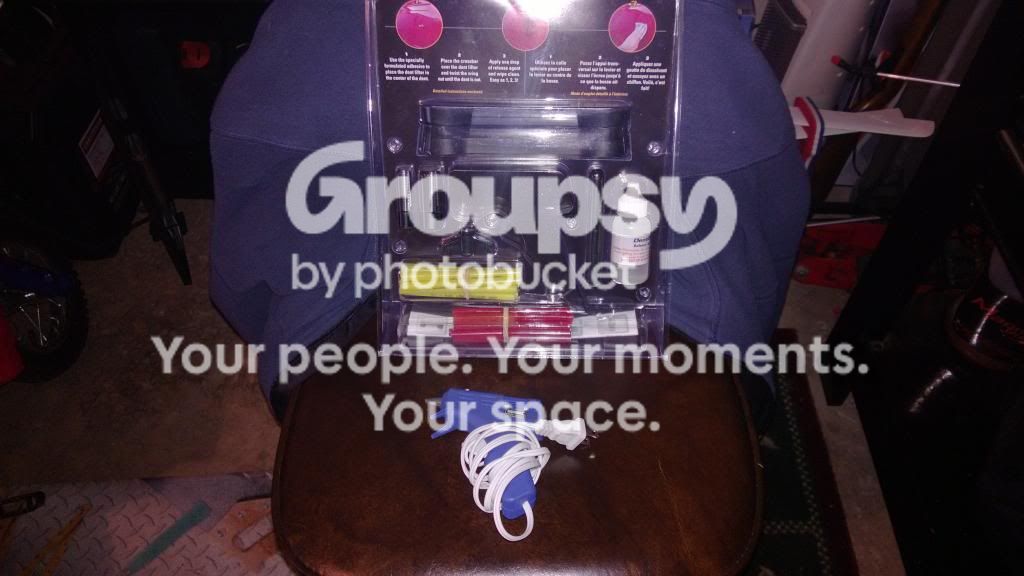

This is what I used:
It comes with two sizes of dent pullers, a glue gun, two colors of glue sticks, a tool to fix a high spot should one be created by the pulling, and the cross bar. There are yellow glue sticks and red glue sticks. The red is for pulling dents in 75-95F temperatures and the yellow is for pulling dents 55-70F temperatures.

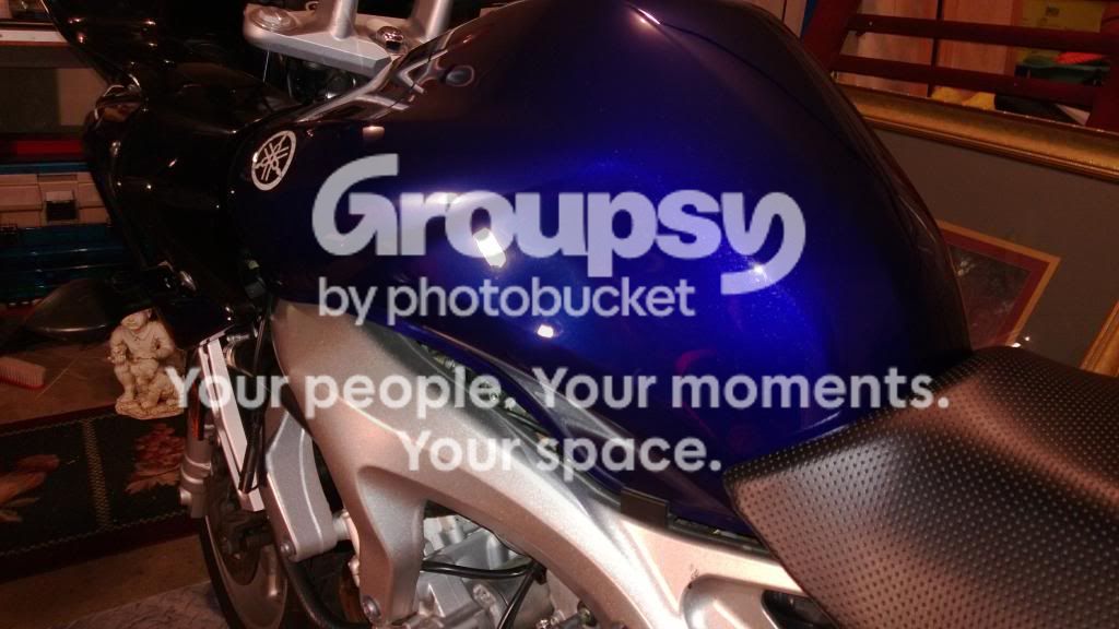

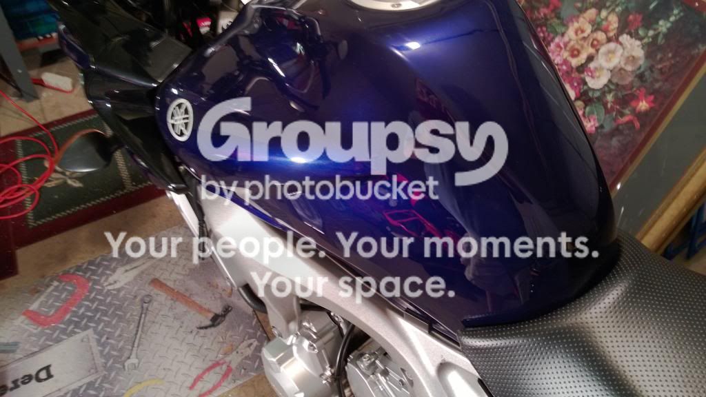

Here's a couple of shots of the dents before repairs.
Sorry for the lighting, I tried to do my best when taking the pictures to show the severity and size of the dents. The dent closer to the seat is actually much larger than the dent that's on the contour line.

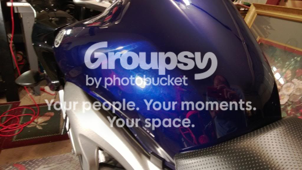

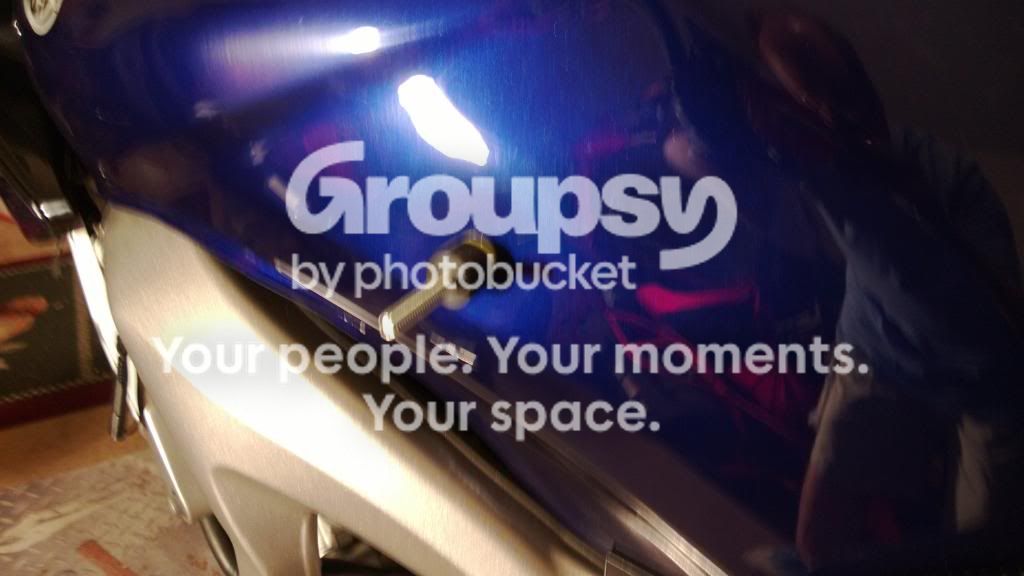

To use the dent puller, you put some glue on the end of the dent puller and place the puller in the center of the dent for about 10 seconds or until the hot glue has cooled so that it will hold itself up. You then place the crossbar over the puller and turn a wing nut until the dent pops out.
Here's what the dent puller looks like attached without the crossbar:

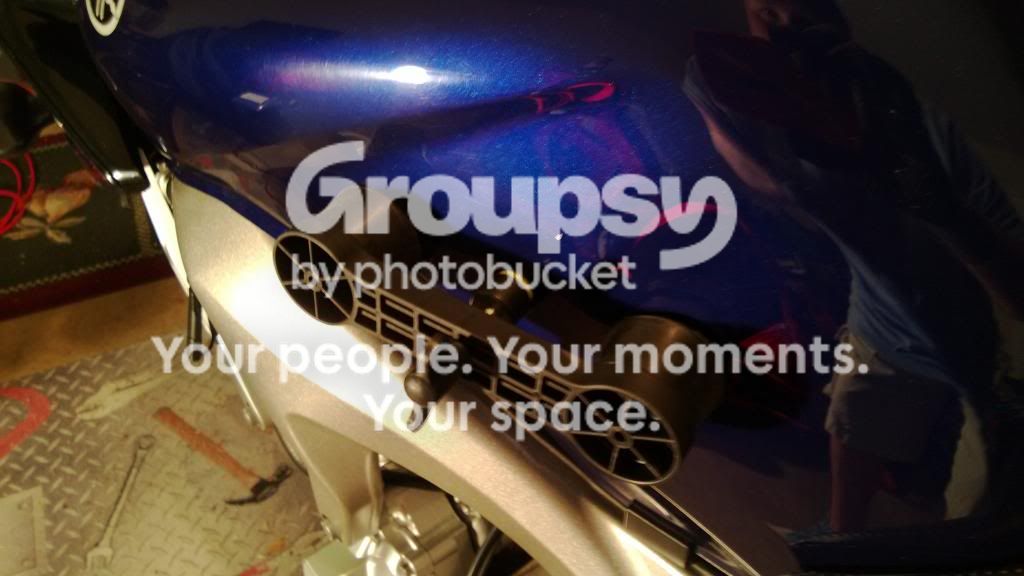

And here it is with crossbar in place ready to pull:
You turn the wing nut until the dent is removed and repeat the process until you have the desired results. One problem I had, was the lower dent (closer to the front of the bike) had part of the dent that fell on the contour line of the tank. This effectively means that complete dent removal of that dent is not possible. I did manage to make it much smaller and less noticeable, but the dent is still there. Now the dent closer to the seat and a little higher on the tank was completely removed by the puller or at least to about 95% where you'd never be able to tell.

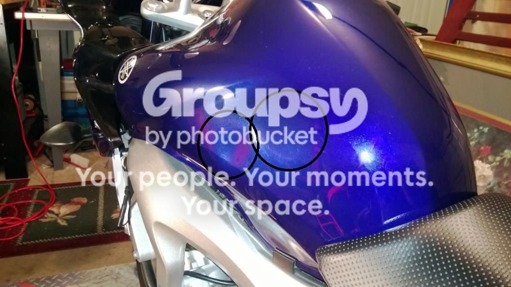

Here's a couple of after photos showing the results.
You can certainly see how much of an improvement there is. Overall, I'm very impressed with the results and I consider the kit $35 well spent. It's certainly not professional body shop quality, but it is of course, much cheaper (and fun). Also, it only took me about 1 hour of total time from start to cleanup to remove the dents. I'm looking forward to getting out of my wife's van, a couple of door dings my son put there when he opened my car door into it.

a quick ( prob stupid ) question. You say you glue the tab to the dent, how does or do you remove the glue ( glued ) part from the bike?
Also how many times can this be used?
Other then that, looks awesome, i dont have any dents but i know what i will be buying if i do
The only stupid question is the one you don't ask!
The kit comes with what it calls a "release agent". I tried my sniffer to see if I could smell what it was but I couldn't. Once you've got the dent pulled to where you want it, you remove the crossbar and wing nut leaving the dent puller attached. Then, you drip a couple of drops of the release agent onto the puller and glue. The glue then peels right off the metal and the puller.
I updated the picture above and got a picture of the front of the kit showing all the components. Sorry about that, it was late last night when I posted that.
I pulled those two large dents out and used up one stick of the yellow glue. The kit comes with quite a few of each of the glue sticks so as long as the glue sticks last (not sure if you can buy more).

Just an update. In today's natural light, the dents are certainly better, but I may work on the one on the contour line some more and see if I can get it just a little better. If I can, I'll post an updated pic.

I ordered the same kit you pictured in the first post. Tried it out last night.
I had a smallish, pesky dent from where the PO's knee was when he dropped it during a low speed fall.
Worked like a champ! Had to go through the process twice to get it right, but I can barely see anything resembling the dent now.
Thanks for the recommendation! :rockon:
