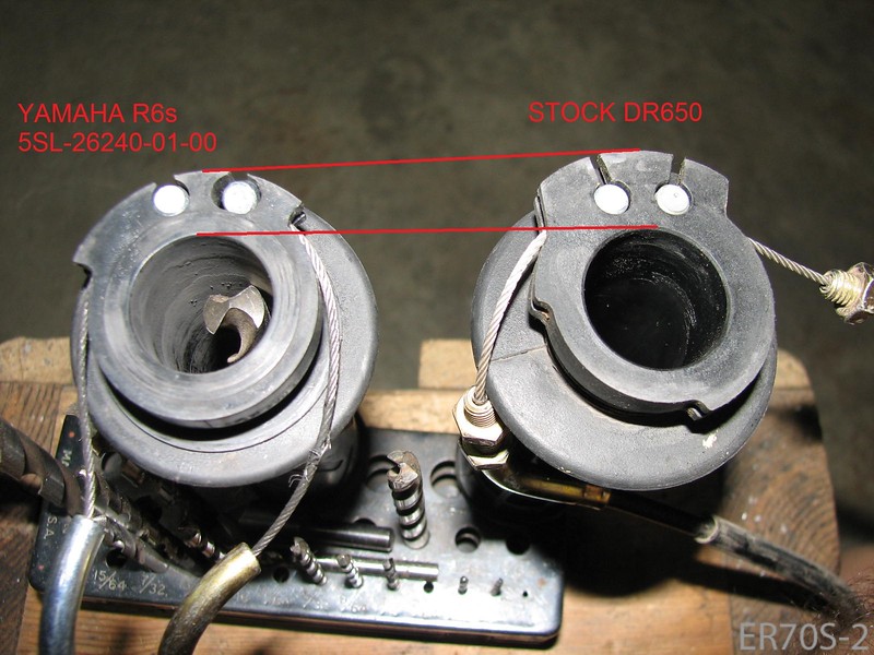

It's actually much less to it than you think. If you can change an air filter on your bike you can open up the throttle cable housing and lube the cables and then put it back together.
It's just 2 screws from underneath that are removed, separate the upper housing to expose the cables and then you may be able to lubricate the sheathes without removing them at all.
Also it's a good idea to remove the throttle grip tube completely and lubricate where the tube rides on the metal bar end. I did mine finally last year and it was dirty and a bit of rust under there! cleaned it up and polished it with an air buffer and then coated with silicone grease and the throttle has felt much smoother ever since. Plus now it won't rust more.

Once you remove the top of the throttle housing you will see the cables running around the end of the throttle tube. There are 2 cables, one opens the throttle when pulled the other is called the return cable which helps the throttle grip return to closed when released. Both cables are connected to the throttle grip tube end using barrels, just like the end of the clutch cable.
The important thing is to take a picture of how they are attached before dissasembling, makes it much easier to reassemble!
You turn the throttle grip to give one cable enough slack to pull the barrel out of the throttle tube and then turn the grip the other way to remove the second cable. Installation is the reverse. Just make sure you dont' mix up the cables. The cable tubes only go into the lower housing one way so it's usually pretty obvious how the go back together.

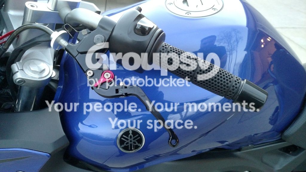

Got my shorty levers installed, and clutch cable lubed. WOW what a difference.
The levers feel great, and the 2-3 finger method feels much more natural. Also, pulling the levers in a couple clicks really made the reach a lot better.
For the cable, I got some ink cartridge syringes off amazon. My brother ended up putting 4mL of Royal Purple 5W-30 in my clutch cable, and it made a world of difference. The friction zone has 10x more feel to it. It's a night and day difference when it comes to smoothness and feel now. Feathering the clutch is almost effortless. Feels a lot less jerky from a dead stop, and every shift even feels more crisp. I even stalled it a couple times because of how different it felt. I will DEFINITELY make cable lube one of my annual maintenance tasks for sure. I couldn't believe how much of a difference it made. My brother has only been up and down the street twice on my bike, and he noticed a huge difference as well.
