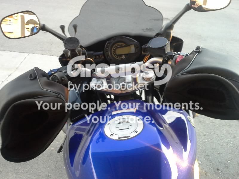

When it comes to cold weather riding, I've become an expert. I ride through the winter regardless of how low the temps are and I can stay relatively warm with my heated jacket and gloves. I do not have heated grips, but I do have mittens that cover my hands which cuts out the wind from the cold and makes a huge difference. The trick is to turn off your heated gear about a mile out so your bike has a chance to recharge. Your battery is actually draining at anything less than 4k rpm, so whenever you're stopped at a light, be sure to keep a steady throttle and bring up your rpms up, don't just let it idle at 1300.
