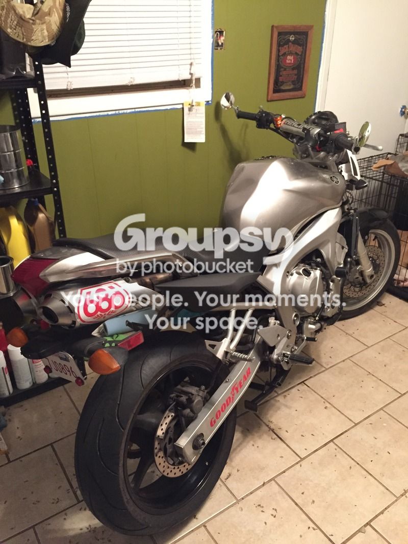

Hi everyone the names Riley. I just recently traded my cbr250 for a 04 FZ6 and I'm loving it. It was pretty banged up when I got it and I am slowly doing all the maintance to get it back up to brand new again. If there is anyone on here from Oklahoma let me know so we can go ride one day.

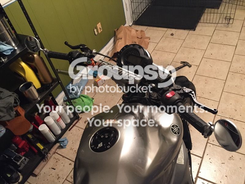

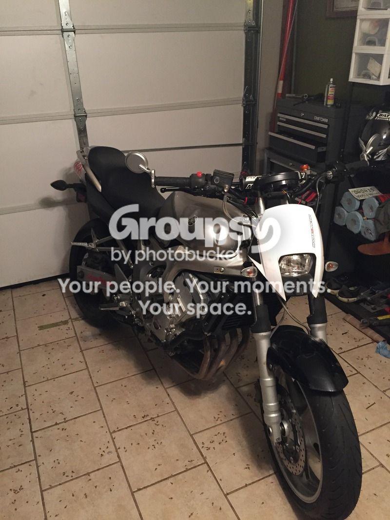

It was a straight trade. I'm hoping I'll up the value after I get done fixing it. There was also a crap ton of stickers on the tank and everywhere else that I removed from the bike. So far I have fixed a coolant leak, replaced the spark plugs and wires and also got a new air filter. Just doing that has made a huge difference. I need to replace the cam chain tensioner though, I hear some ticking on the right side of the bike, which after looking it up, that seems to be the case. It has around 25000 on it, so the valves will need to be checked in the near future. Still a bunch to do but I'm in love, have always wanted a bike like this. The only other things I have done are after market levers and a phone mount.

The tank is really beat up. The guy that had it before me didn't know how to ride a bike. Only had it for a month and did a lot more than you think someone could to it. I plan on getting a new gas tank in the future. Hopefully repainting the whole bike and getting all new parts that are scratched up. And I guess it's not really a tick, it's more of a smack. The smack/tick will go away once the Rpms are up, that could be valves though too. I have a new cct coming in Friday, so I'll see if that fixes the noise, if not the valves will be my next guess. Thanks for the information!

I found another leak from the clutch cover and fixed that and I also replaced the cct this weekend and all is good! It runs smooth and doesn't leak a drop of coolant or oil and doesn't make any noise at all. I want to thank everyone again for posting in this thread and helping me solve the problems. I really appreciate it. :thumbup:
