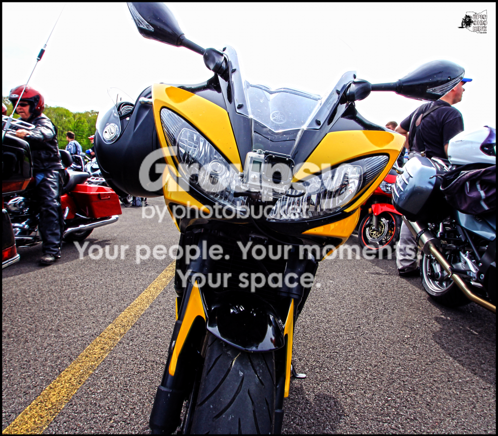

Nope, no problems at all. I'll see if I can get my son to hold the camera for me this weekend and try to mount the GoPro and compress the front suspension (as much as I can anyway). There's plenty of room.
It might rub a little if you're gonna be going a lot of stoppies (sp?) :)
Here ya go. I knew I posted some pictures on here before. if you need more/different pics, let me know...
http://www.600riders.com/forum/bar/42983-gopro-hero2-3.html#post467911
Excellent.....thanks!
No need to try getting pictures with the suspension compressed. If it's not presented issues for you that's good enough for me :thumbup:

I thought about mounting it there but was worried it'd hit under hard braking, the one time you'll need all the travel and it might bottom out early or cause an extra jolt when not expected.
I guess you could put a cable tie on the forks and go out for a good ride and measure what the travel is to the available space. Then work out if the gopro is safe to be there.

According to the manual for my 2007 the suspension travel is 5.12" (full extension to full compression).
Since Eddie has not had any issues I'm not to concerned but I'll probably take some measurements just because there might be a difference between his 2006 and my 2007.

I got the 5 year old boy next door to hold a camera for me (he did a really good job!). Check out the video, it shows the clearance between the camera and fender (about 3.75 inches at it closest while on the side stand), then I bounced on the front as much as I could, trying to compress the front suspension as much as possible while sitting still.
2006 Yamaha FZ6 with a GoPro Hero 2 mounted under the headlights. The clearance between the lowest point on the GoPro and and fender is about 3.75 inches. I compressed the front as much as I could while sitting in the driveway to illustrate the clearance you'd have between the camera and fender. I believe the front end would probably compress more under hard braking, but how much more I really don't know It felt like it was almost hitting a stop when I bounced on the front while holing the brakes (in this video).
Hope this helps...

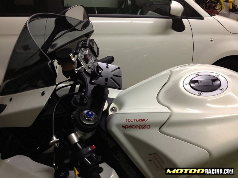

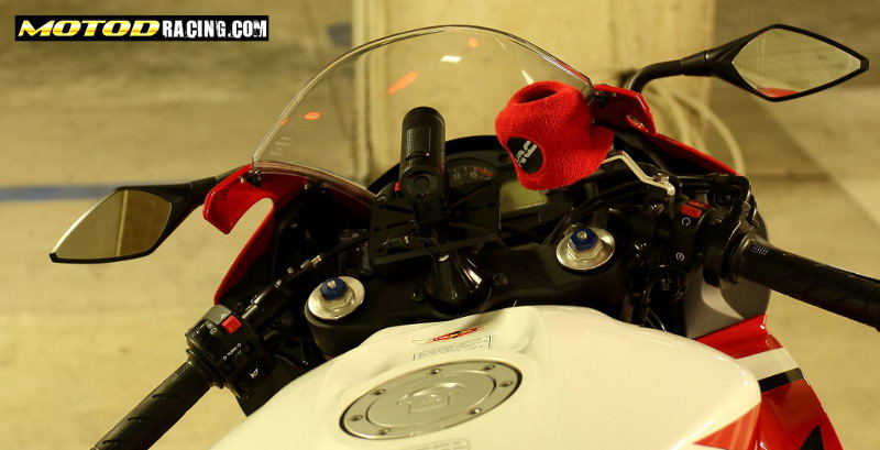

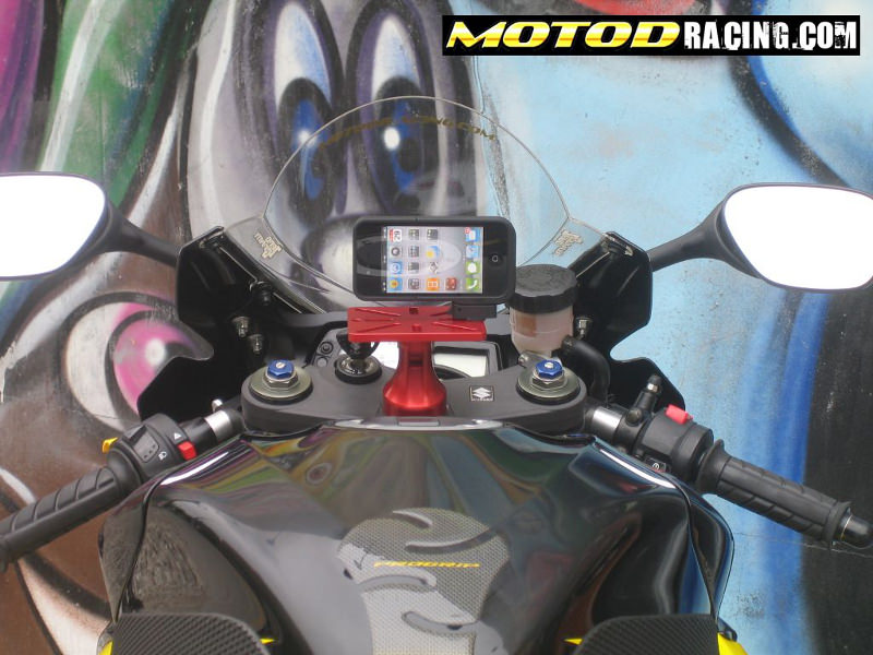

The Best Camera mount for the Motorcycle is available atPerformance Riding Motorcycle Accessories ? MOTO-D Racing
