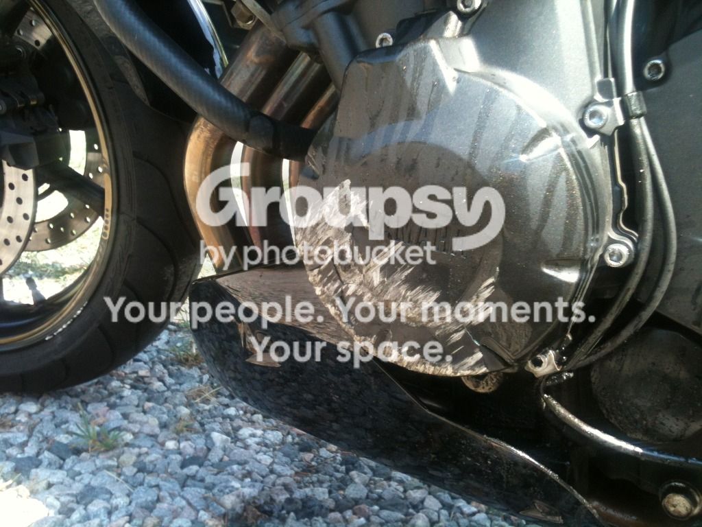

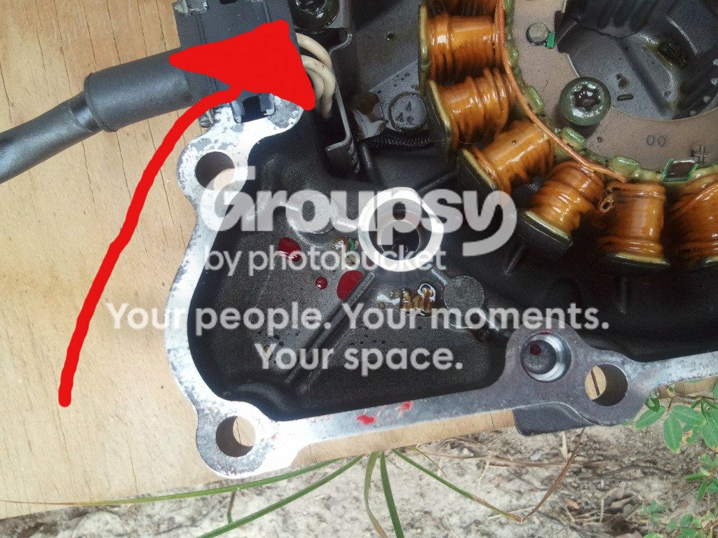

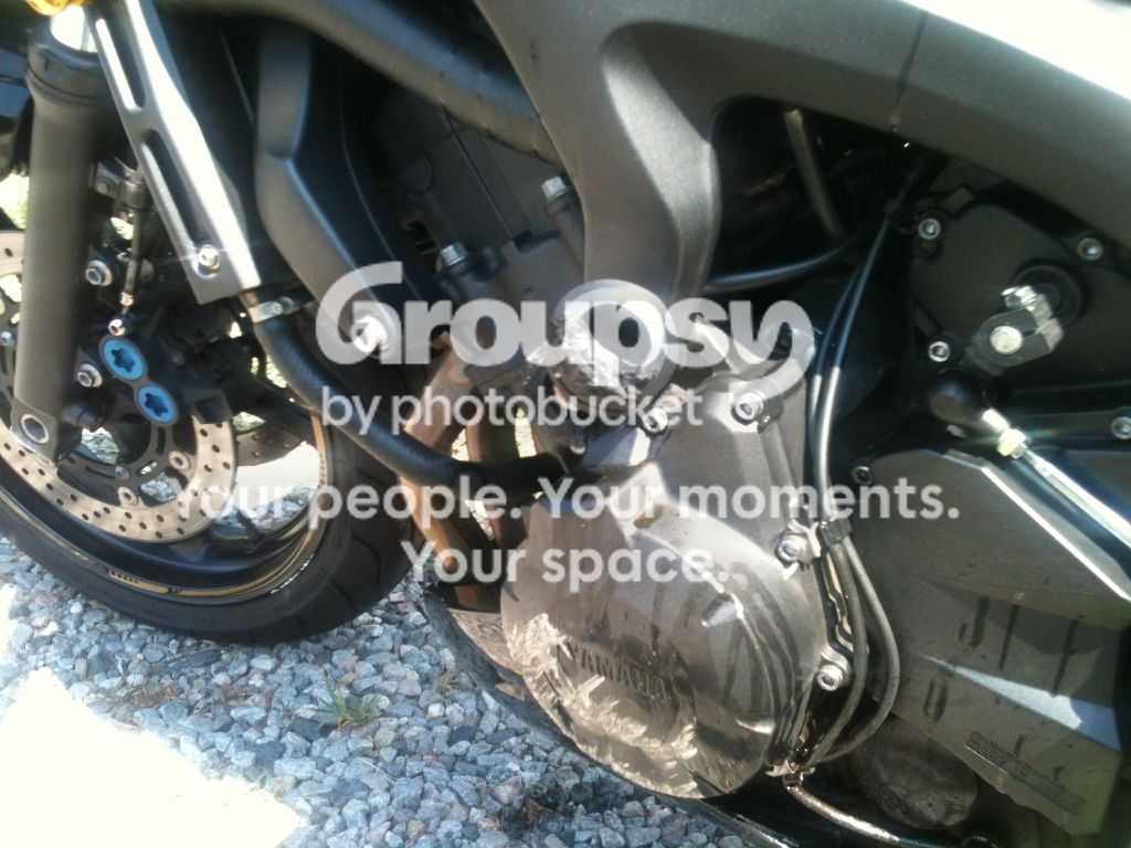

Started to tear the bike down and ran into a problem.
took off the handle bars, speedo, headlight and assembly, rear, tank and then the !@#$% stator cover!!!!!!!!

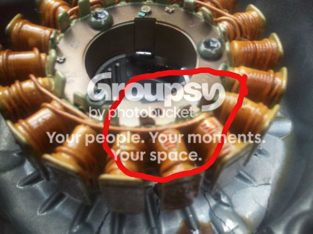

notice the copper tabs exposed

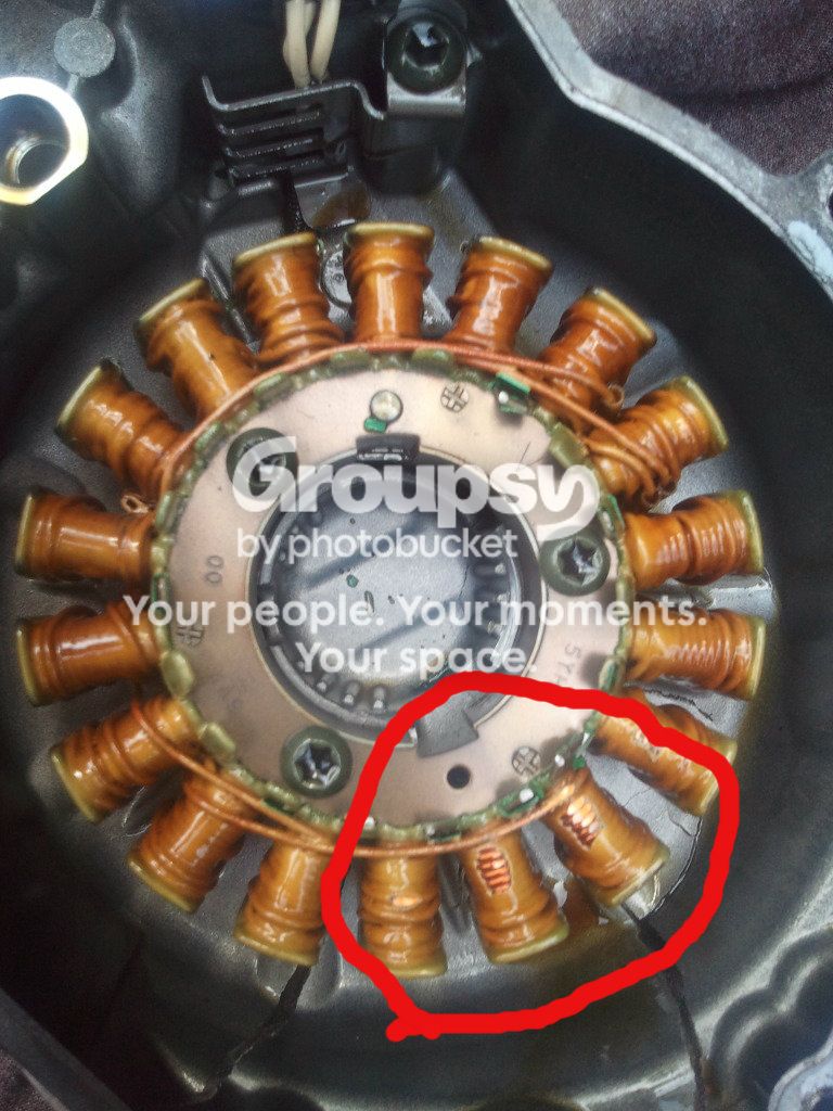

another angle

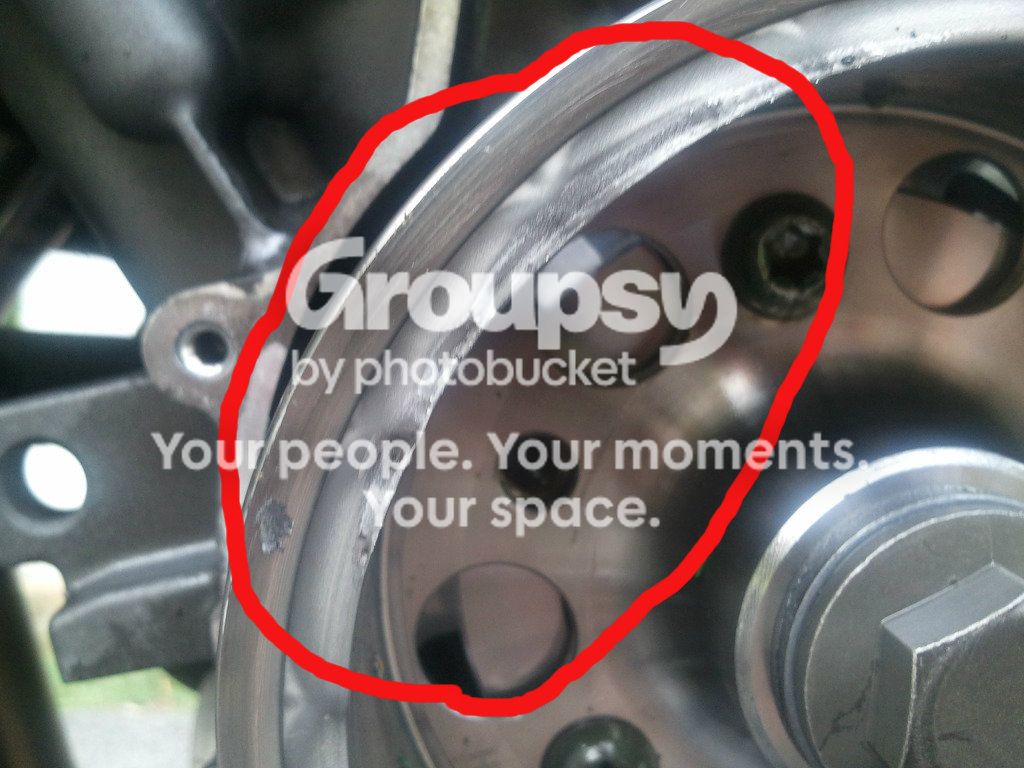

scratched cylinder guessing from the stator hitting it
the end of my day slicing my thumb open, i couldnt get the bolt and i just dont have my strength back yet. and the with the meds i didnt know i was bleeding until i noticed the blood in the cover. i should have gave it another day.
so is the stator ruined or is it no big deal, and whats the verdict on the cylinder thingy. just need to know if they are going to need to be replaced.

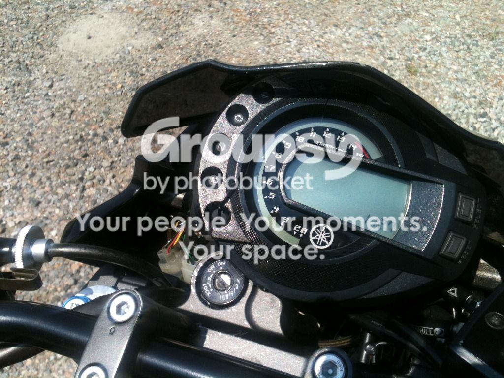

If the speedo is still working you can run it until you find a new one.

As for starting the bike, the tip over switch likely killed the motor pretty quick. Its likely ok to start normally once the stator cover's been replaced BUT, if you want to make sure, pull the spark plugs, GROUND THEM (on the valve cover) and crank the motor off and on for a minute or so. This is just in case ANY ENGINE oil got into the upper cylinders, to prevent hydraulic lock and further damage...

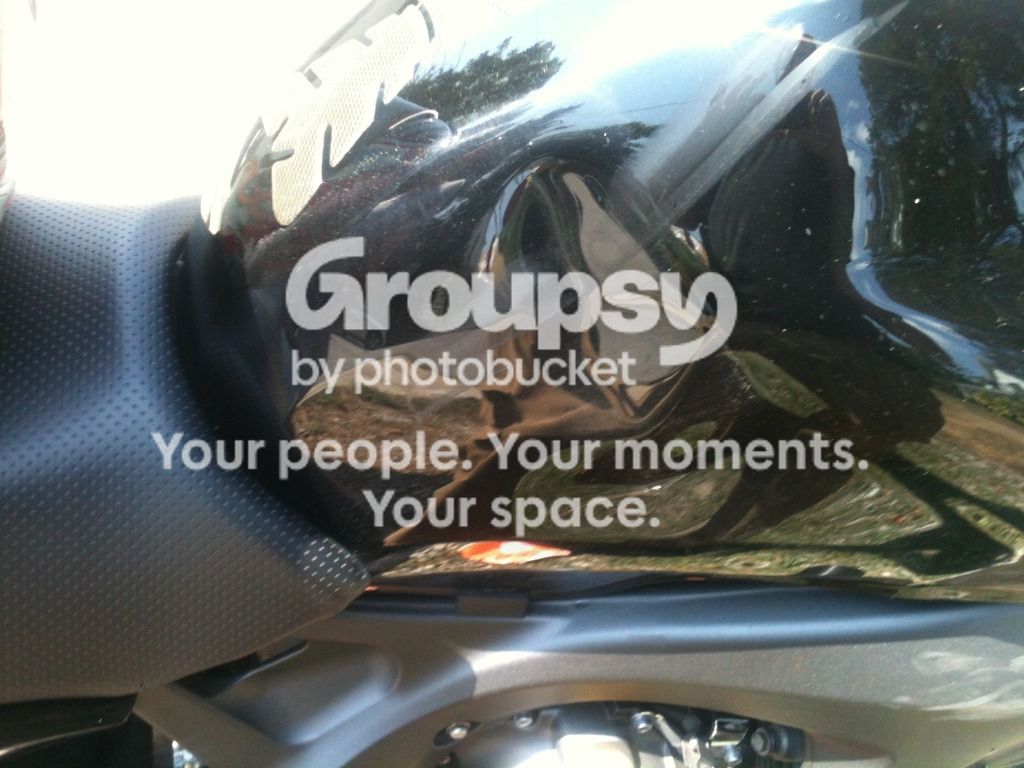

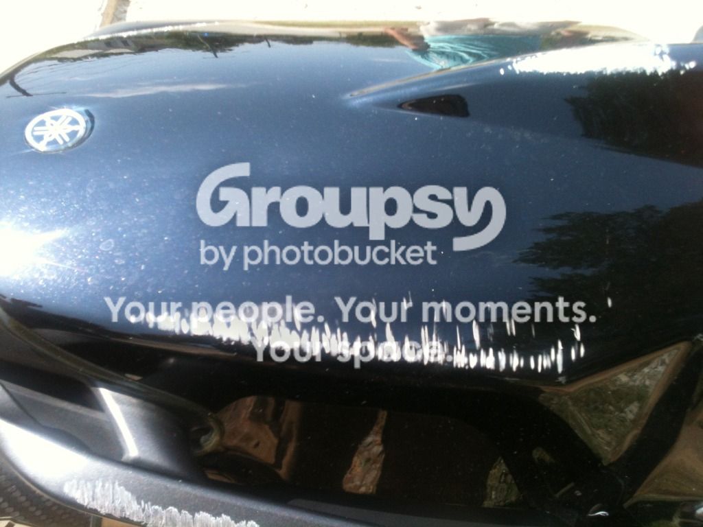

As for the gas tank, looking a the damage you sustained, it should be rideable. Look for any leakage (especially under the tank where the pump bolts up, there's a rubber ring gasket), top off with a gas can (at home), cold engine, and again check for leaks. The fuel pump should be ok, its pretty safe in the middle of the tank. It takes alot to get the FZ tank to leak.
Get better!!!:thumbup:

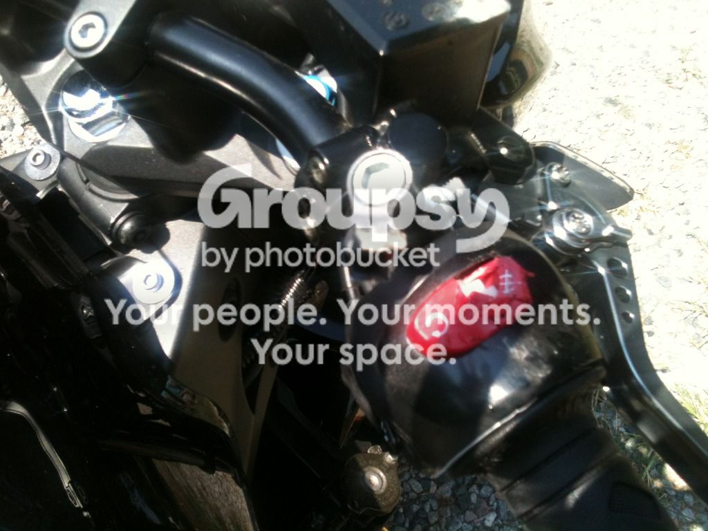

PS, save the guts to the RH switch as the kill switch is a weak point and you may be able to later re-use the separate switch..

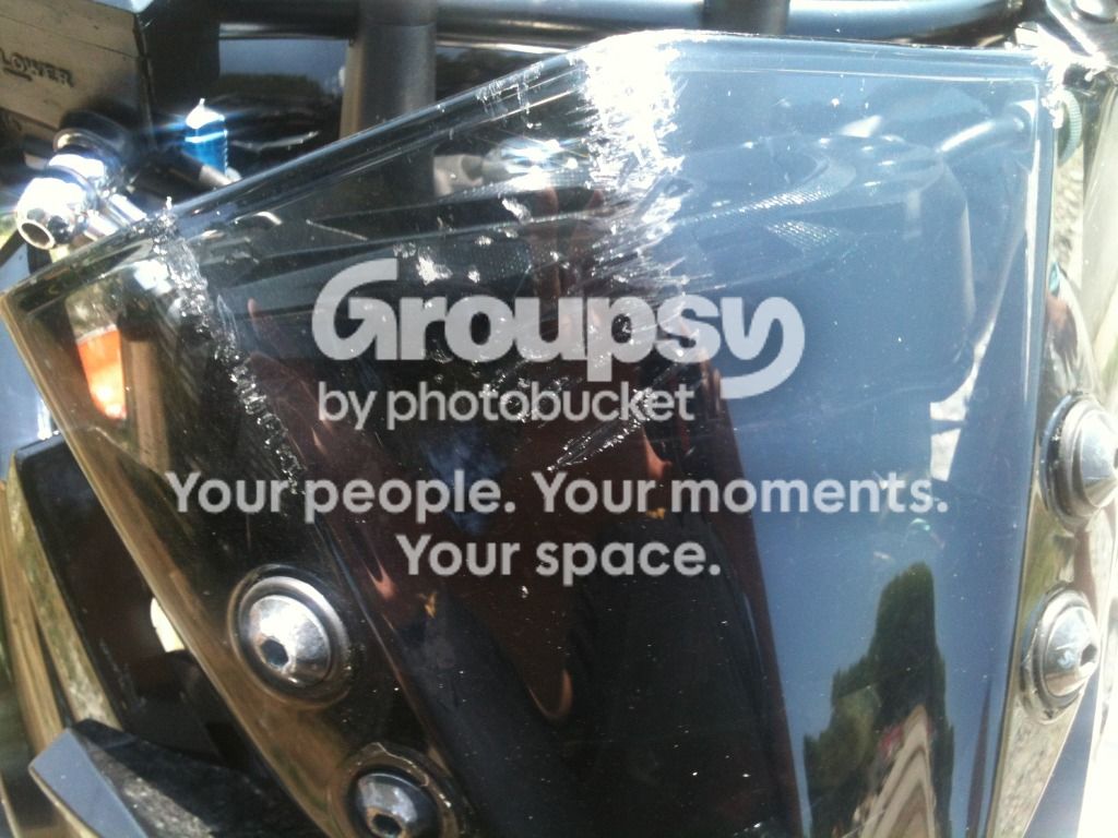

seems to be working fine thing i may be able to super glue it back together for the time being.

Any one think its possible to get that larger dent out a bit? think i could get one of those leather covers they have for $100+ and wait for a good deal on a new tank.
Can the tank be bondoed/fiber glassed and panted? is that not something you do to a bike, or is it just the same price wise to but a new one?
